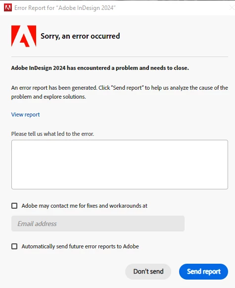

My InDesign app crashed, and the automatic recovery didn't work. An Adobe error report keeps popping up and close the app.
I can open the file through "Open Recent," but it seems to be corrupted since I'm unable to save it as a PDF or IDML.

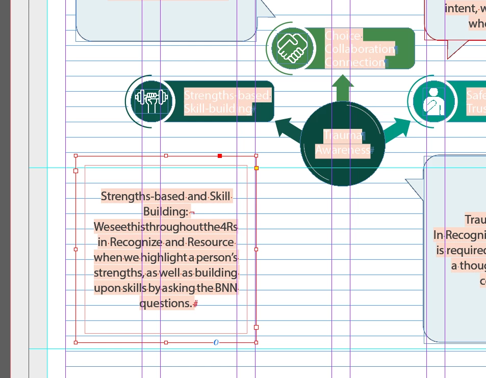

And this is the problem:
InDesign crashes when trying to copy this frame.
Attached is IDML file without this one group.
Or rather the problem is with the graphics element in the background as, after ungrouping - TextFrame can be copied - and file IDMLed - so the problem is definitely with this graphics:
@textualist40349006, you should be able to open your original file, remove this group and create new one from scratch - or ungroup, delete the "background" graphics and create new one - and your file should be like new.

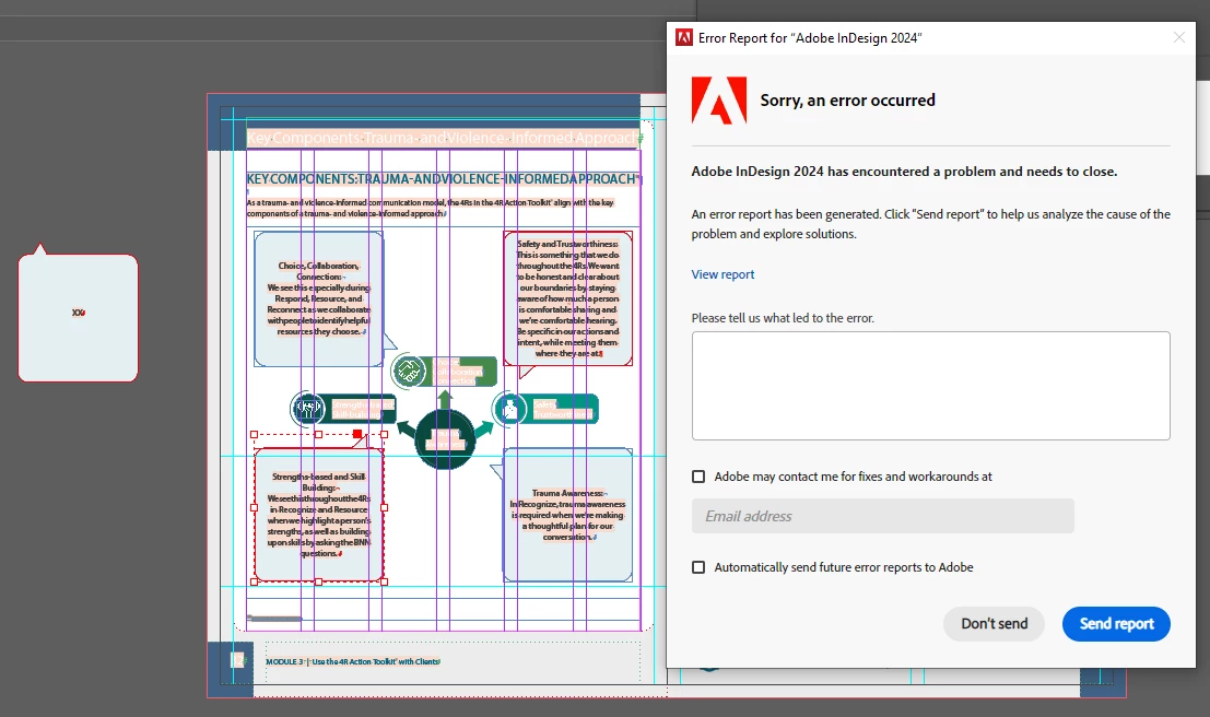

I'm using the 19.5 version, Windows 10 Professionnel.
I just tried to move the pages to a new document, but same issue occurs, An Adobe error report pops up and close the app.
Please find attached my INDD file.
