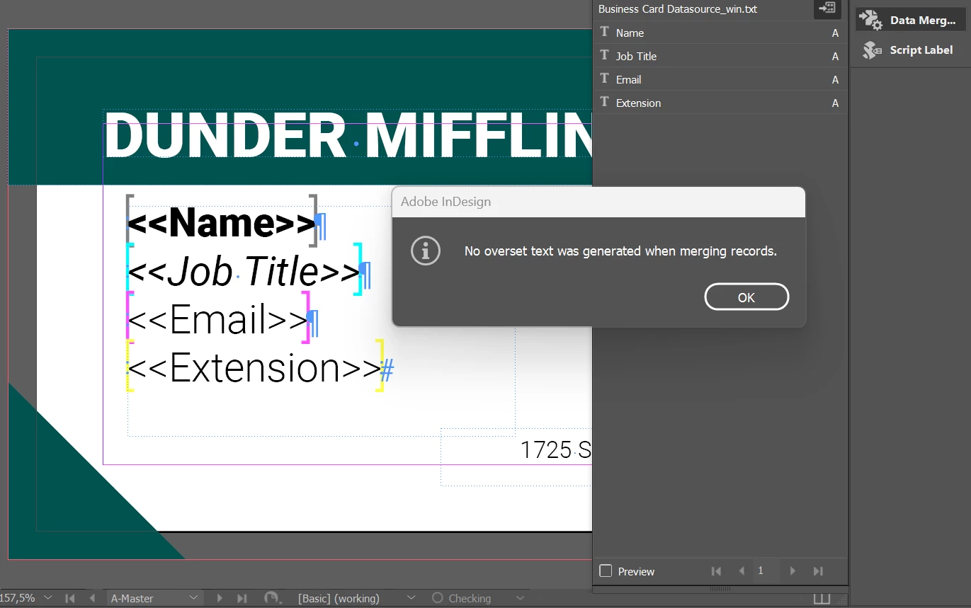

I have business card file like this (attached). And it still gives me 8 text error messages, I have installed the font from file, which was with business card and also from creative cloud. I can't get rid of error messages about text. In data merge preview window all 6 cards looks perfect, but it does not do those six different cards for me. If preview file gives all well, it can't be error in .txt file, I made from Excel (all other works do fine, only this business card). However, I attach it. I have no more ideas - why it does not work out for me?

Dec 28, 2022 1:43 PM UTC
Your sample file is not a Data Merge template, so I have no idea what you are doing. All of the content is on your Parent Page (A-Master) which is OK if those are merge fields, but at the moment they are just text frames. We need to know exactly what the errors are that you are experiencing when you try to merge, and it would help to have a real template and sample that show the problem.
In General, Data Merge Preview is historically buggy and can cause errors, including permanently damaging a template file so that it never merges correctly. From my perspective it is better to not use it at all -- just run the merge and make corrections if required before running again (use a subset of the data if it is very large set). If you do use Preview, immediately Undo before running the merge for safety.
Dec 28, 2022 3:19 PM UTC
Thank You for Your answer. Data merge template works fine, there is smth wring, with the business card, .indd file. If You use data merge file in some empty page, it runs out. Snapshot is here, just colorful squared brackets, it - data merge template just does not work onto that business card, what I must use, have tried everything:
What else should I try? If I make a new business card, data merge template works fine, but not on that, In no ways, cut off frames and did stuff, still no result. Data merge template attached.
Mikk
