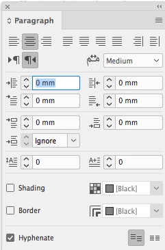

December 17, 2019
Hey there, Select the table (not inside) and check the left indent in "Paragraph Panel" makesure it is "0".
