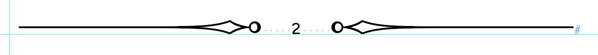

I attached a screenshot. I had the page number variable (and header is the same) in its own text box, in front of vector graphic page dividers that were grouped together. Apparently, even though they were behind the variable text, they were covering it up in export. I ended up placing each side of the page divider INLINE inside the text box with the variable, and it fixed the issue. In the second screenshot, you can see the invisible spacing on either side of the number.

It's very likely that those headers are there in the HTML but are hiding behind something — an image, a background colour, perhaps even a text box that is obscuring them. The fixed-layout export from InDesign is truly a mess, unfortunately. Can you isolate any reasons why the glitchy pages are happening? Or is it random?
