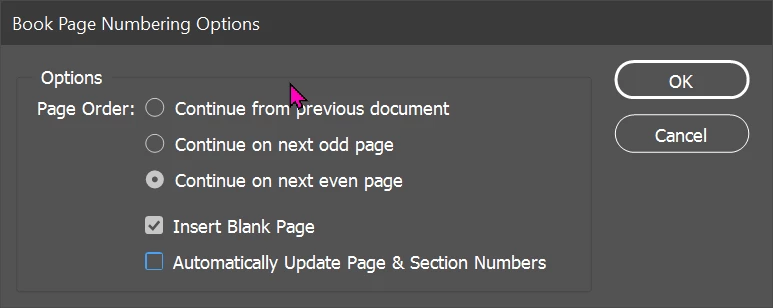

  • Check your book settings to see if you have turned on Insert Blank Pages.

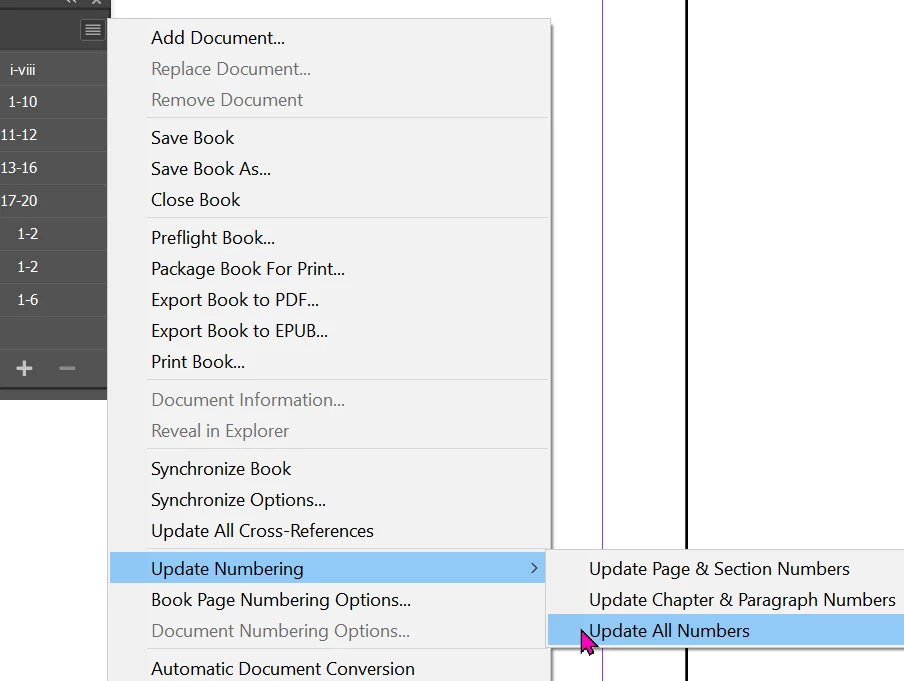

  • Also, in the same dialog box, see if you turned off Automatically Update Page & Section Numbers. If so, update all numbers manually.

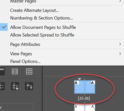

  • For pages that must remain a spread, in the Pages panel, select the pages, and turn off Allow Selected Spread to Shuffle. Note: this could leave a break in the page layout; Allow Document Pages to Shuffle can cause strangle page layout breaks too.

Check your 23-page section to make sure that auto-flow hasn't added an extra page. If the document is indeed 23 pages, try exporting it as IDML, re-saving as a new InDesign file, and updating it in the book.
Look for a checkbox to Allow Pages to Shuffle - this may fix the one errant right-hand page. If it dones't, then use the IDML procedure on this one as well.
