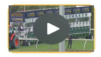

I’m in desperate need of help with an issue I’ve been facing in Adobe InDesign for the past month. When I insert a video and resize it with rounded corners and a stroke, it looks fine initially, but then the corners keep flicking back to square. When I publish, it looks very wrong (corners rounded, but video square inside the round) and this has become incredibly frustrating since images work perfectly.

I’ve also noticed that when I use the “Fill Proportionally” option, the blue bounding box shows outside the frame, which isn’t correct. This issue is seriously impacting my ability to create a weekly magazine that is done for my job, and I really need the videos to display correctly when published.
