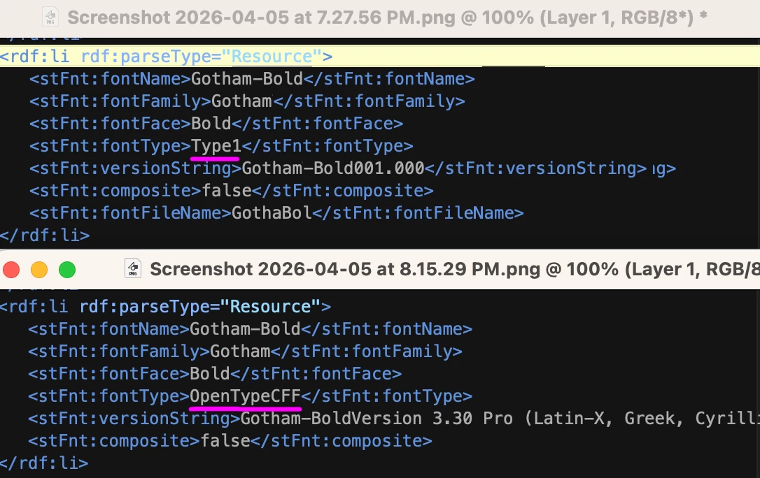

    Part of the issue is the way InDesign stores information internally for fonts, etc, etc. It will include the font type along with all its other relevant data.
    You can see this if you save out an IDML file and open that in an XML editor (like BBEdit): the Resources > Fonts section will list all the fonts used in the document and also the type.
    The problem lies in that this internal database doesn’t necessarily remove all the old references, so even if you do a Find/Replace and switch to Opentype version (which is what I assume you are doing), you have to get EVERY reference to it, which means updating all Styles that have Gotham applied, used or not. Regardless, InDesign is properly using the correct font outline as it recognizes fonts by the internal PostScript name, but since there’s a mismatch with the font type, it flags those by adding the “(T1)”.
    THEN you have to save the file so the database gets properly rewritten. Sometime you have to save out as an IDML file and reopen it to clear out all the old cruft.
