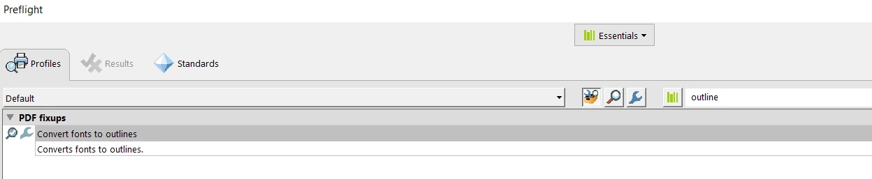

Where did you purchase the fonts?
And what is the EULA state for embedding the fonts in exported pdfs?
If they look ok on your end you can outline them in the PDF - which is better option.
In Acrobat go to the Preflight Tools
Just make sure the EULA of the font allows this - or else you're in breach of the license you agreed to when you bought it.
You should contact the font vendor to see if they have a version that allows proper embedding.
