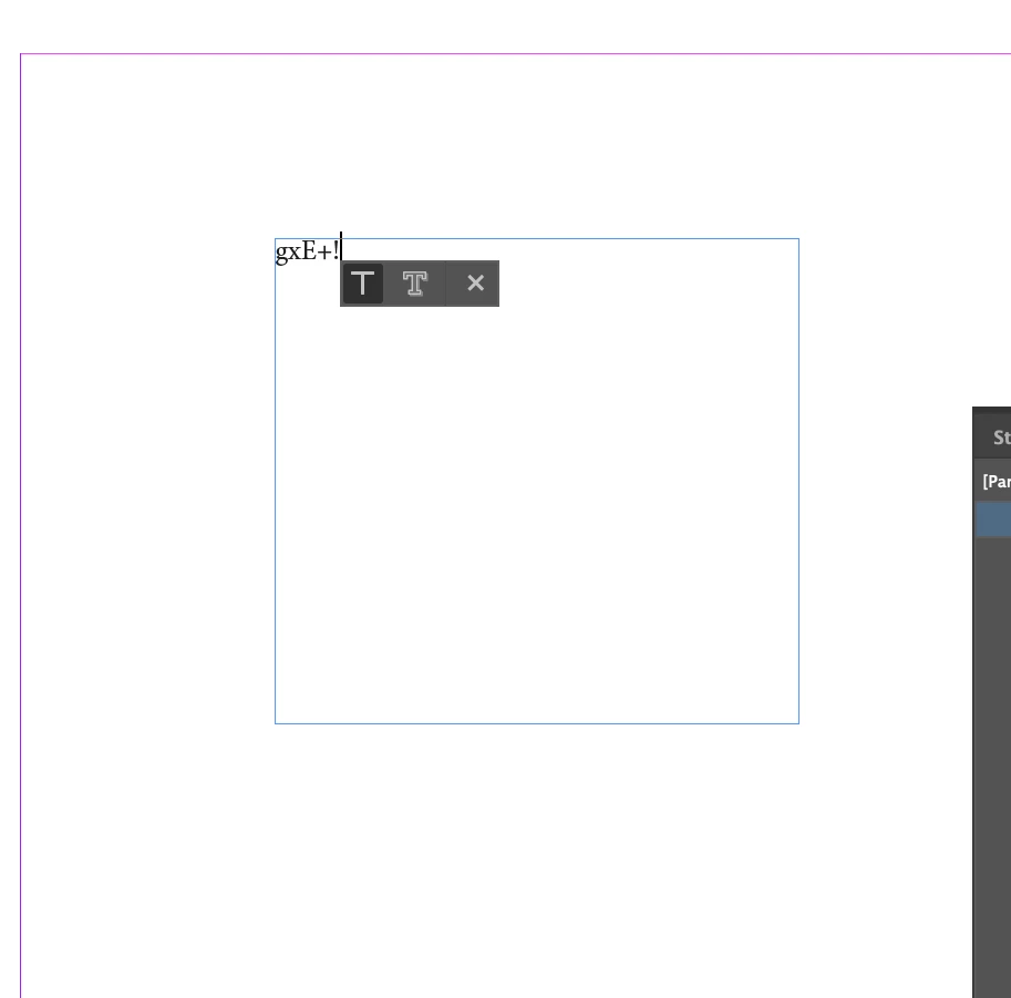

Hi All,
Can you please anyone help me on font issue why it's not supporting in in-design?
Font name : Seagull: Textile Care v1.0...Actually this is symbol font. In illustrator it's working but not in Indesign. Please suggest if any body have an idea?
I have tried to keep in
"C:\Program Files\Adobe\Adobe InDesign CC 2014\Fonts"
"C:\Program Files\Common Files\Adobe\Fonts"
but not supporting and it's showing same issue.

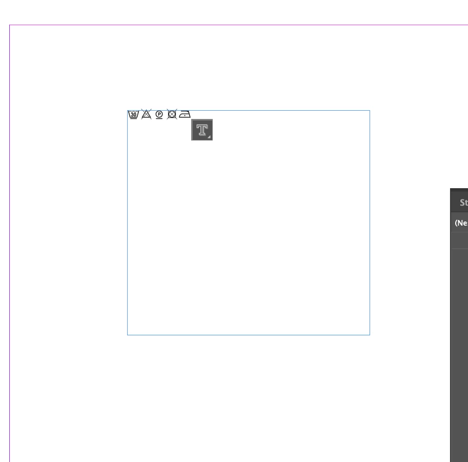

    Hi, now in Adobe Creative 2023 try this workout:
    copy all your textile text care letter in illustrator, because illustrator support Seagull Symbol font.
    Than copy all the paragraph in Illustrator and paste in Indesign.
    You have 2 opportunities paste without or with style from AI.
    Select the secon icon, with format, and here are all the symbol.
    Than it's better than you create a paragraph style, to apply more easily the correct style.
