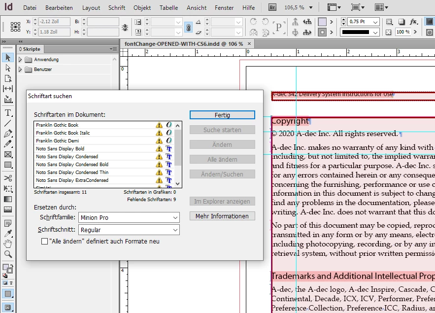

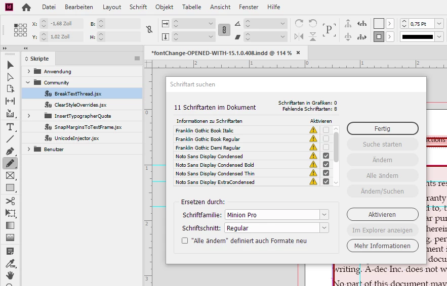

Hi Rob,
ah yes, from my InDesign 2020:
From my InDesign CS6:
Uwe Laubender
( ACP )

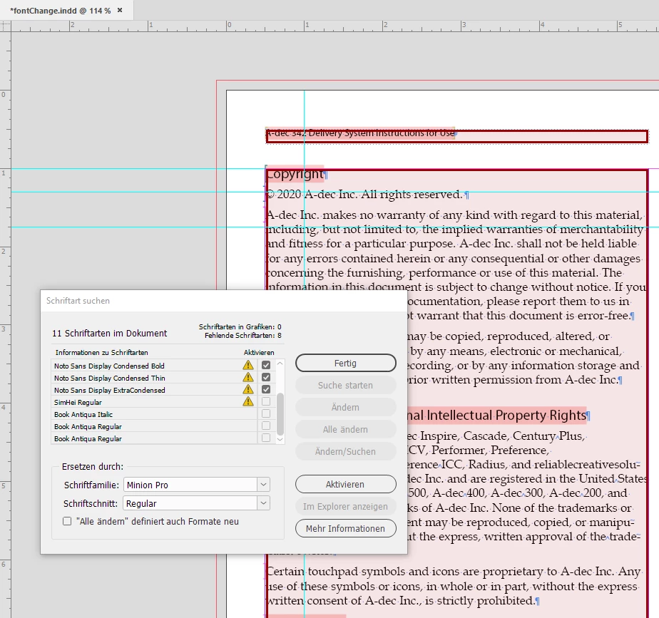

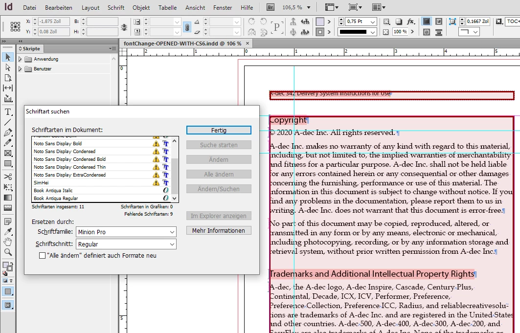

April 23, 2020
Hi Joseph,
my Find Font window with InDesign 2020 is looking a bit different:
Exported the document to IDML, opened and saved it with InDesign CS6 and get quite a different Find Font window:
As you can see InDesign CS6 is listing Book Antiqua Regular only one time. InDesign 2020 two times…
I wonder what to do with that now.
Uwe Laubender
( ACP )
