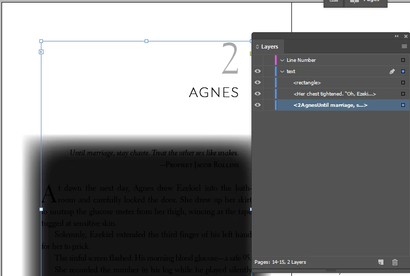

Hello All,
Thank you for all response and study on this subject.

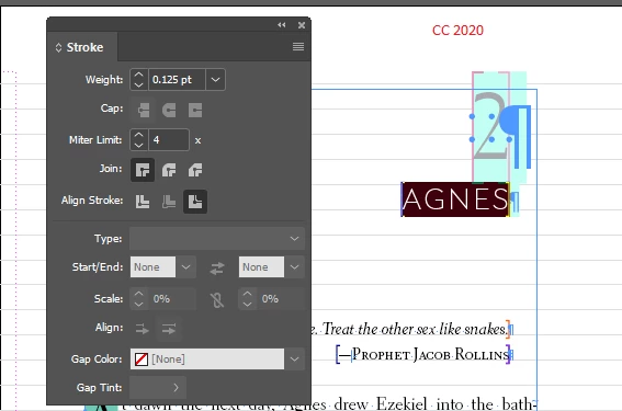

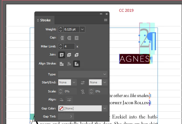

I was unaware that a stroke was applied to the text. Basically, stroke is not part of the style. Now I have corrected them.
But, one thing nudges me. Why I see the difference in thickness level when the stroke value is the same in both CC19 and CC20 versions. I'm not sure this something that happens with this particular font or any conversation issue between 19 and 20.
I  have attached, a screengrab of the stroke value from the live file, and the output pdf.
Any answer will be helpful to understand the issue happening during conversion.

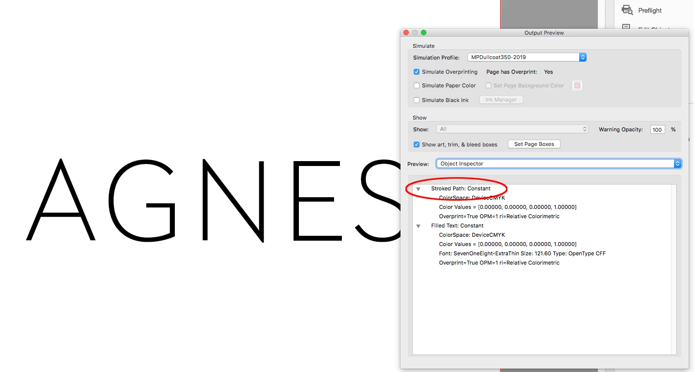

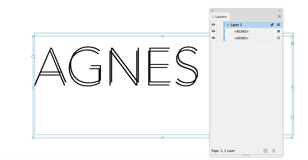

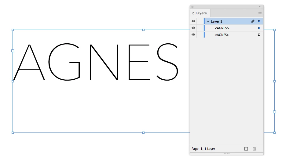

As Eugene pointed out your PDF has 2 text objects—there are likely two copies of the AGNES text at the same X, Y position. You can check via the Layers panel:
December 14, 2020
Hi Rob,
Sorry, I don't see any two layers in original InDesign file or output pdf

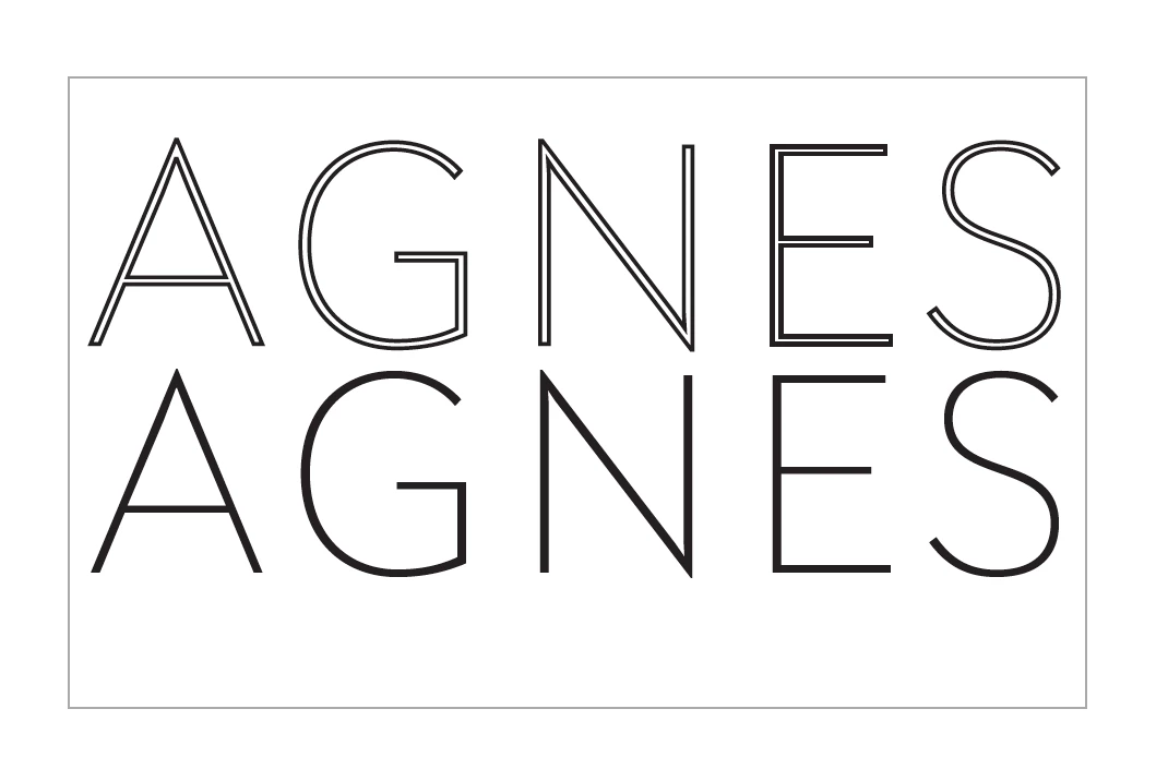

It appears the CC19 version has a separate vector object creating the stroke, above the live type, hopefully that can help you identify its source. One possible explanation would be the stroke is on a separate layer and you are exporting all layers in CC19 and just the live type layer in CC20?

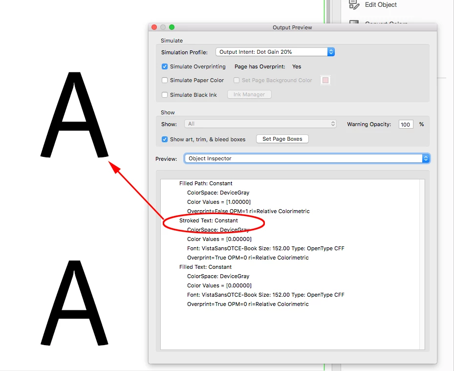

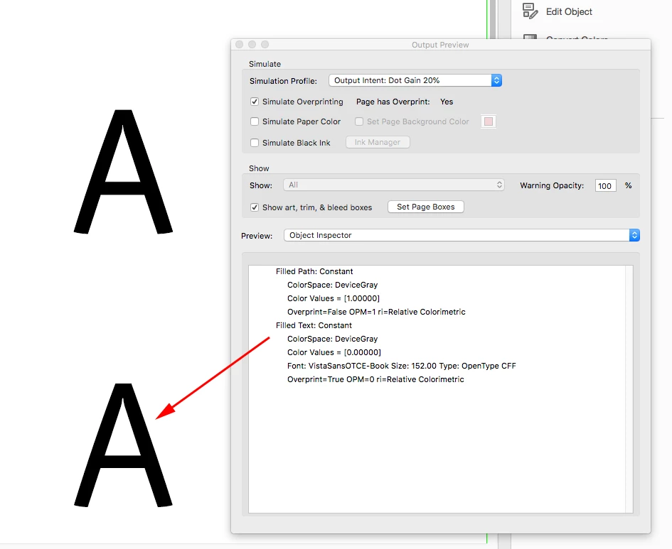

Hi Luke, I think any stroke amount greater than 0 applied to the text will show as Stroked Text in Acrobat. Here the top A has a .1pt stroke applied in InDesign, and the bottom version has the stroke set to 0:

Hi Rob, normal stroked live text should remain as one object, the sample PDF has two objects, one of which is not live type, which is odd, suggesting it was done with some intent, or possibly by an automated workflow (trapping, for example), although the document properties description should indicate this. I can envision a scenario where a client said "show me a version with thin type and one slightly thicker" so the designer made a layer with slightly stroked text (outlined so the stroke alignment can include align stroke to inside). This doesn't explain why the CC19 PDF is different from the CC20 PDF.

If I inspect your PDF the text has a stroke applied. Select the text and make sure there is no stroke applied or the Weight is set to 0.

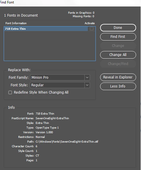

SevenOneEight seems to be the name of the foundry, rather than the name of a font – can you clarify?
December 10, 2020
It's the name of the font. Find the attached.
