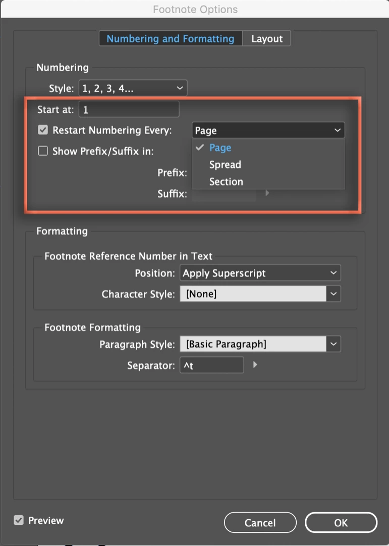

November 21, 2019
I have done all of the above, and still my footnotes restart on every page. I have made sections and clicked in the footnotes option box that they should restart on section. But no change? Any suggestions?
Many thanks!

Barb Binder
March 26, 2019
Hi Kelly:
What does your Footnote Options dialog box show for Restart Numbering? Is it checked? If so, uncheck it.
~Barb
