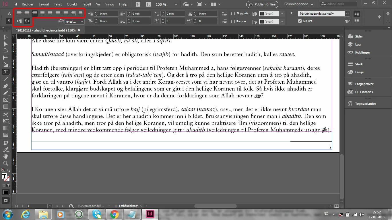

I can see that all your text is in Latin, you need to change Paragraph Direction for your main article to Left-to-Right as such the Foot note will follow same paragraph direction.
Now although text alignment has nothing to do with your question, yet I circled in red both Paragraph directions and text alignment because you have to attend to them eventually when you fix Paragraph direction.

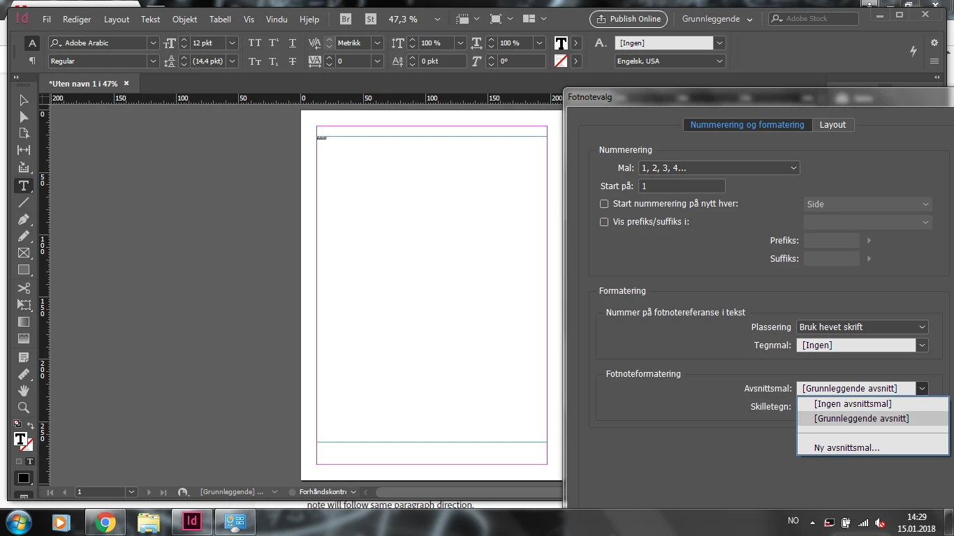

https://forums.adobe.com/people/Mohammad+Modassir  wrote
When i place the footnotes, it shows up on the right wrong side. I want it on the left side, but how? This is a english-arabic version.
Would appreciate help. Kind, Modassir

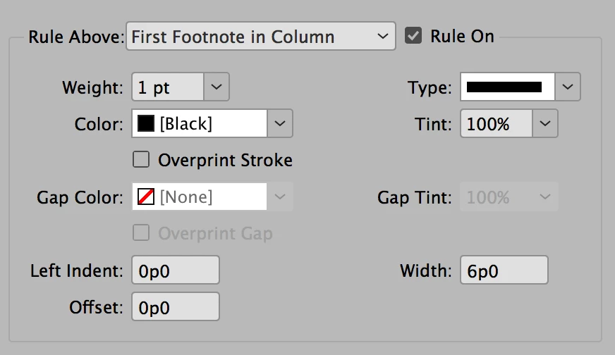

But check to see if you can change the placement of the line in Type > Document Footnote Options > Layout

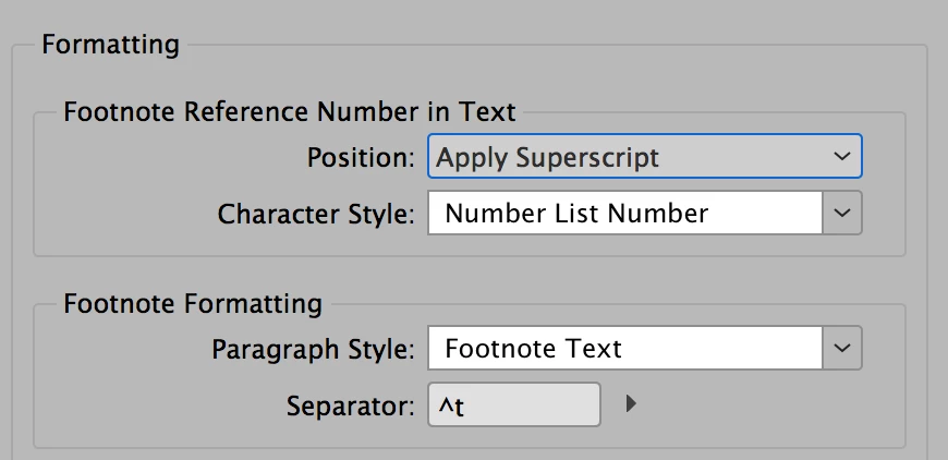

And in Type > Document Footnote Options > Numbering and Formatting, check to see what Paragraph Style you have assigned to footnotes. Then check the formatting for that style. Maybe you need to change the language or the alignment or something else in that style definition?

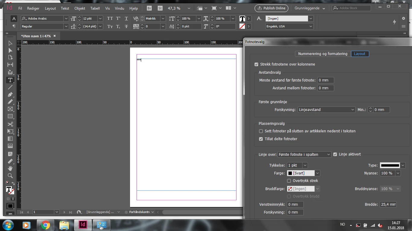

Ok, so this is the Layout of footnotedocument options:
And when i click under fotnote paragraph, it shows only this:
I don't know what happened, but it seems to work now.  Maybe it is because i selected the "English" instead of the default "arabic" i think yes. Thanks!

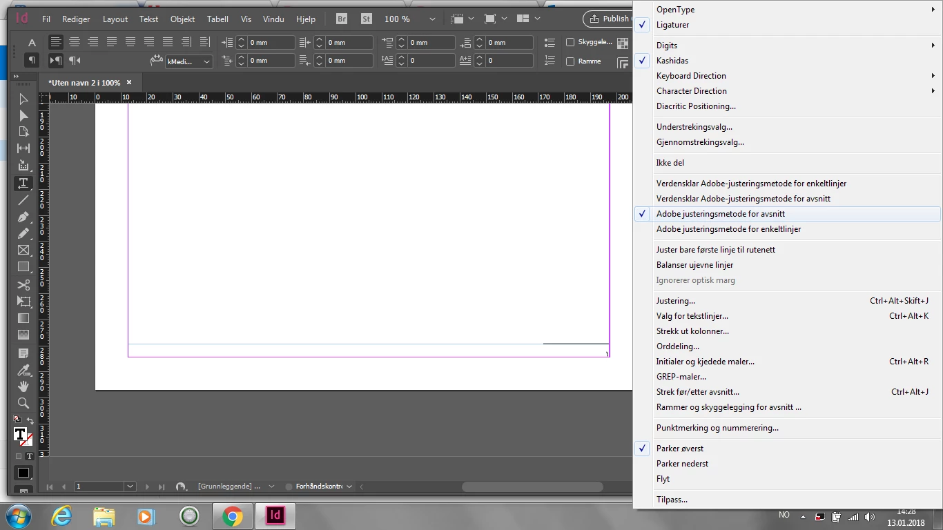

Hi Mohammad,
what kind of paragraph composer do you use for the text of the footnotes?
I suggest not to use the global one.

Mohammad Modassir
January 13, 2018
problem still there when i use as u said, non-global:
