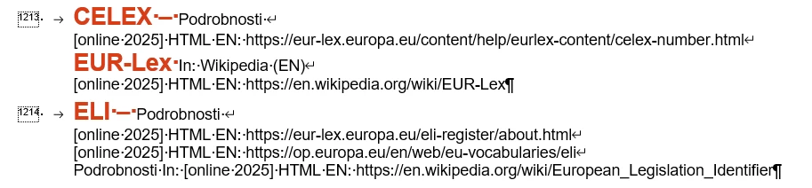

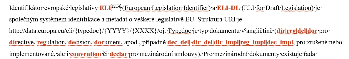

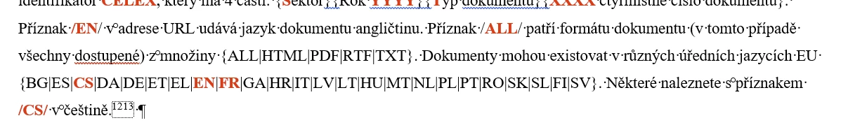

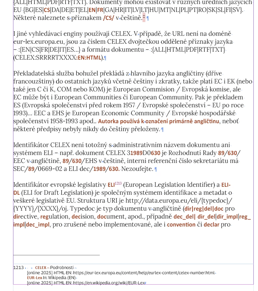

Apr 19, 2025 9:11 PM UTC
Screenshots below... hope it's clear enough.
See the footnote 1213, which is correctly displayed in word document - reference is linked to a correct footnote.
But after import the reference is missing and some weird nonsense character is in the main text instead of reference number. Next reference number is imported correctly, but in InDesign it has the incorrect number (which is -1 comparing to the original word document) and it is linked to the footnote which should be linked to the previous reference (now corrupt, because it's not a number).
(Don't bother with red text color - it's just my internal temporary colored character style for bold.)
Word (main text):
Word (footnotes):
InDesign:
