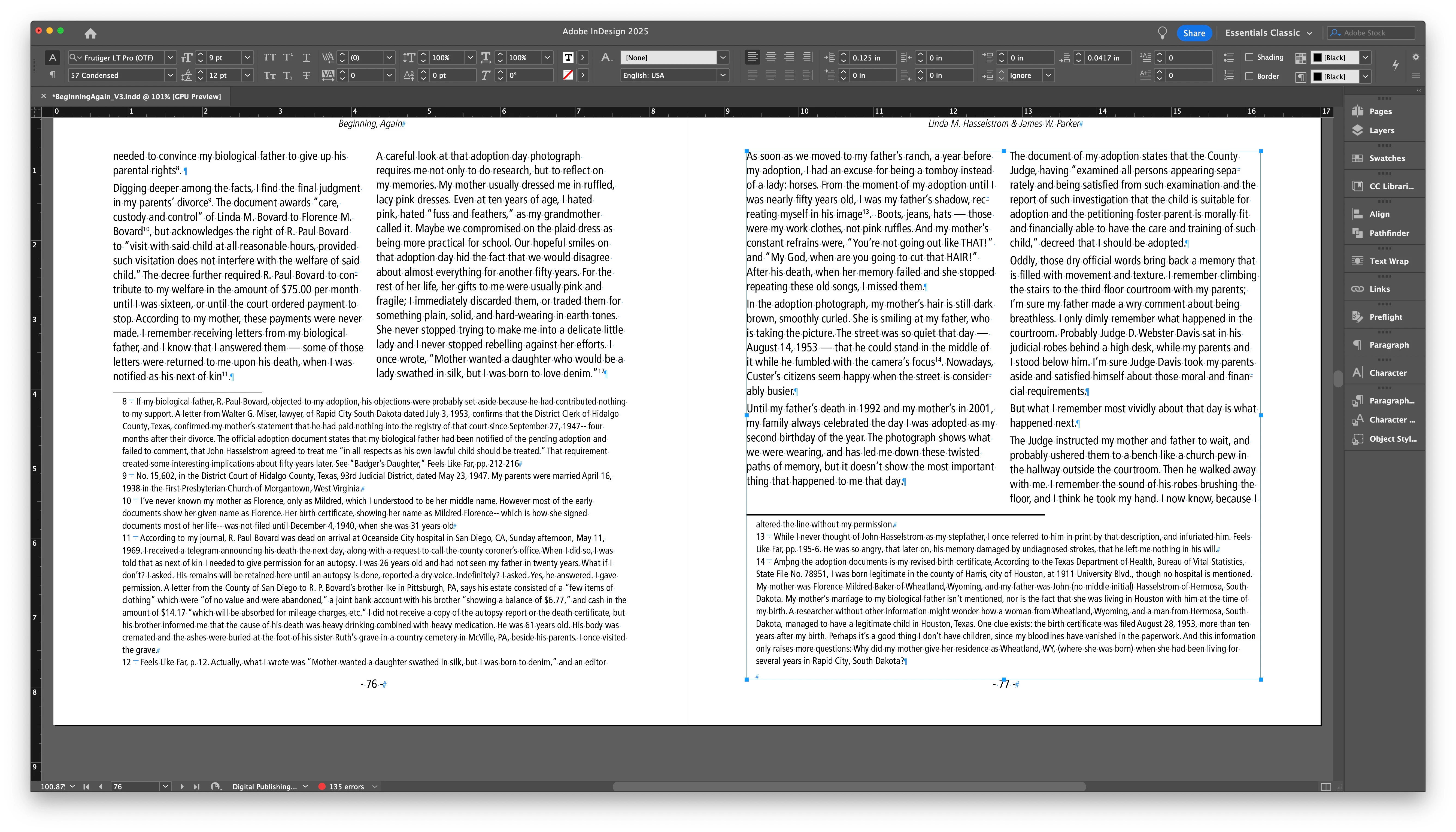

Footnotes spanning 2 columns in InDesign display correctly but do not print properly
First time I've had to use the footnote options in InDesign. I have several pages with footnotes which occur at the bottom of each page in each associated text block. Span across columns is checked in bothe the Footnote Style I created, as well as in the Layout options. The footnotes display correctly on screen as intended.

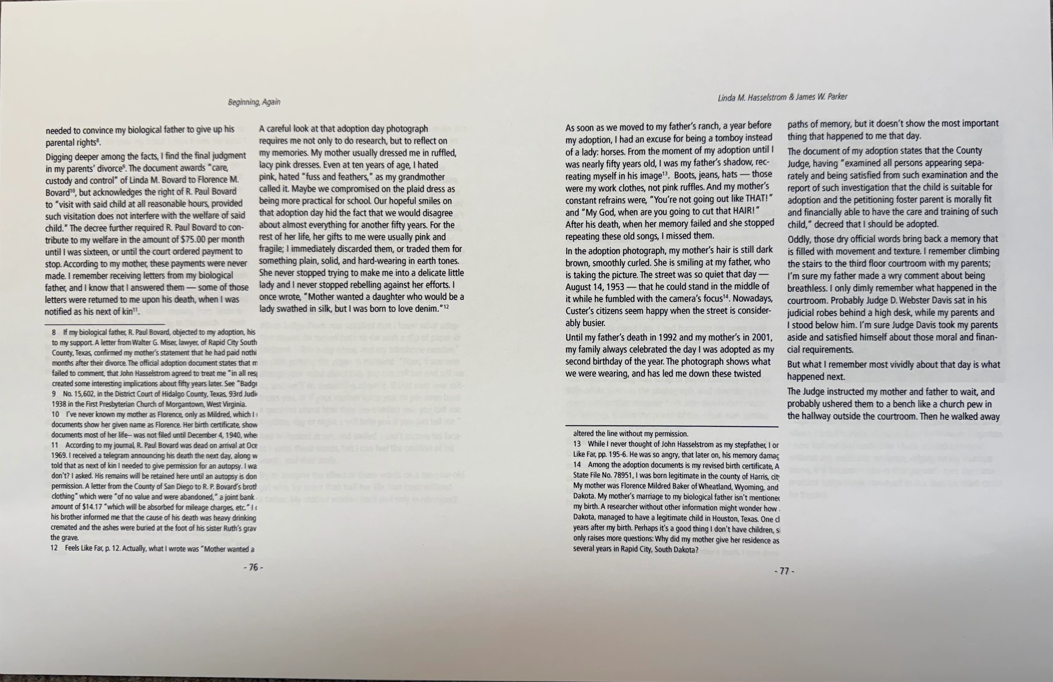

When I print spreads from InDesign to an Epson P5000, the footnotes only print the text that is under the lefthand column. All of the footnote text on the right disappears.
Exporting the pages to a PDF generates the file as it shows on screen, and the resulting file prints to the same printer as expected.
This appears to be a bug in InDesign's printing capabilities.
Anyone have a suggestion as to what is going on?
See the two screen shots to see the problem.
