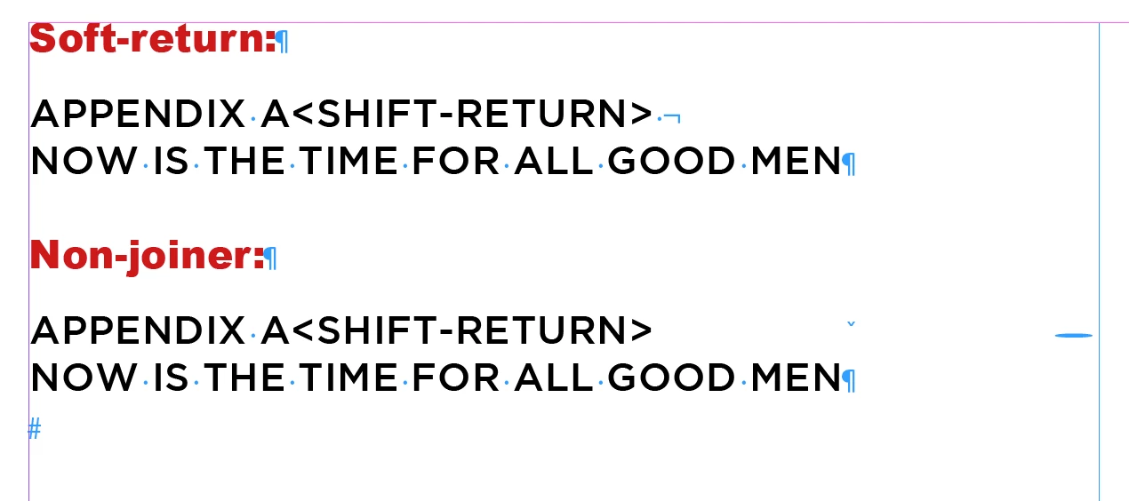

Correct answer FRIdNGE
It's not because you need:
Appendix A<shift-return>
Now is the time for all good men
… on 2 lines that you need a soft-return!
Instead of playing a "soft-return", play a "non-joiner" (+ 2 Grep styles + 2 char styles)!
So, no "soft-return" used, no problem in your cross-ref.!  =D

FRIdNGE
FRIdNGECorrect answer
May 5, 2020
