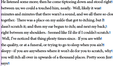

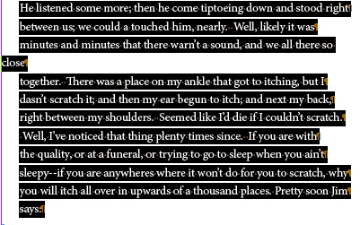

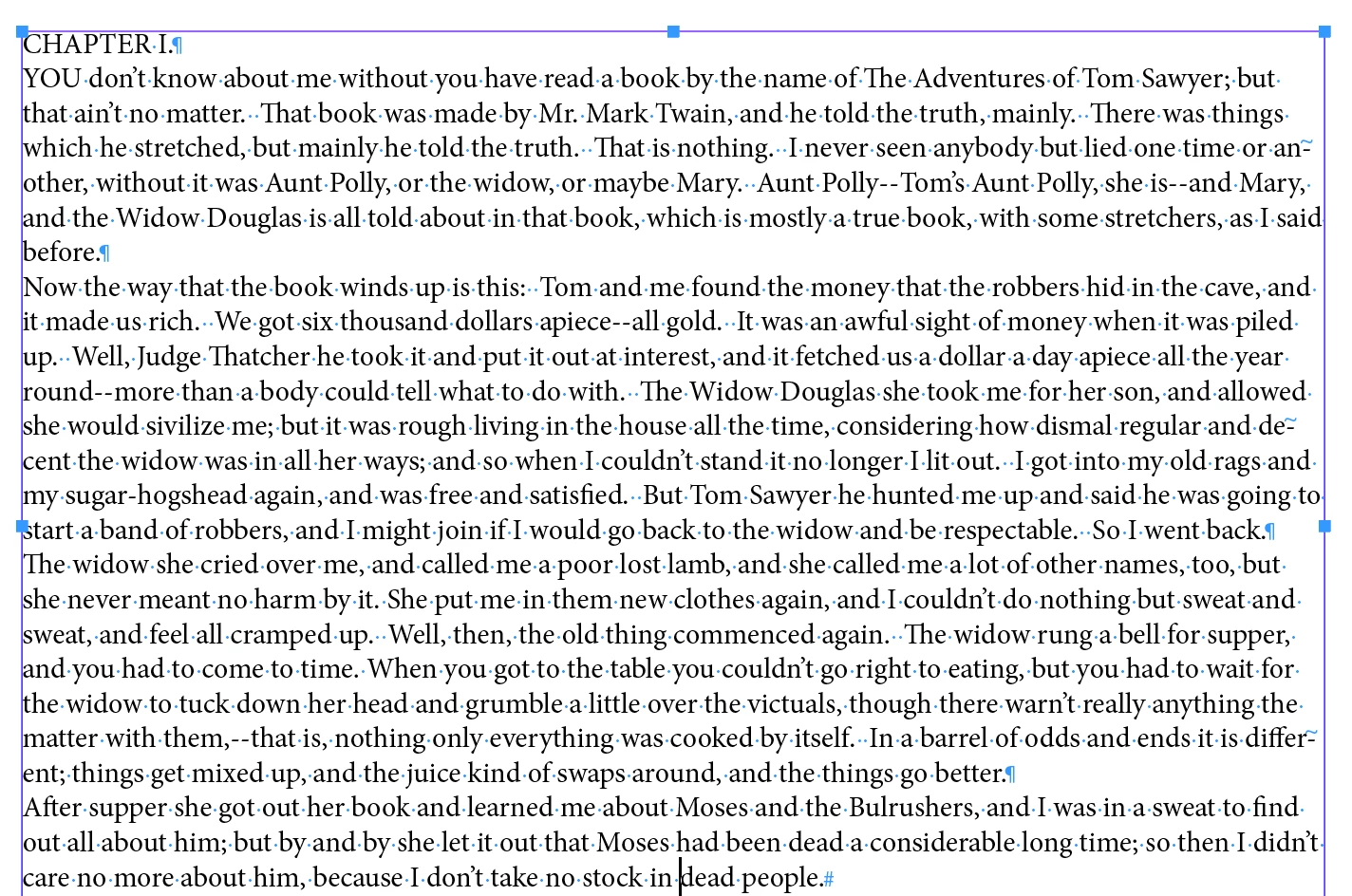

I'm working on a project on Adobe InDesign where I am formatting a book and I imported my text from the Gutenberg project website. The text that I am using is from the Adventures of Huckleberry Finn and I am trying to create my own body paragraph style for the text. The problem I have run into is that each line of text has a return at the end of it. When I try to add in a first line indent on each paragraph, because of the returns, it counts each line of the paragraph as the first line and thus indents the whole paragraph. This goes on throughout the entire text and I was wondering if there was an easy solution to getting rid of all the returns without removing the ones at the end of each paragraph to separate one paragraph from another.

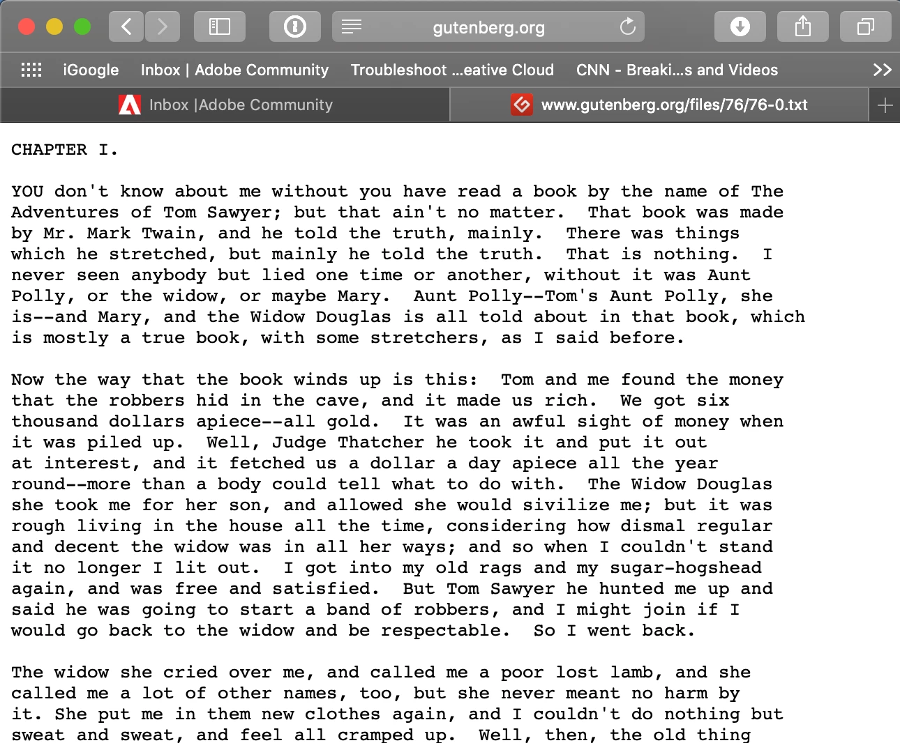

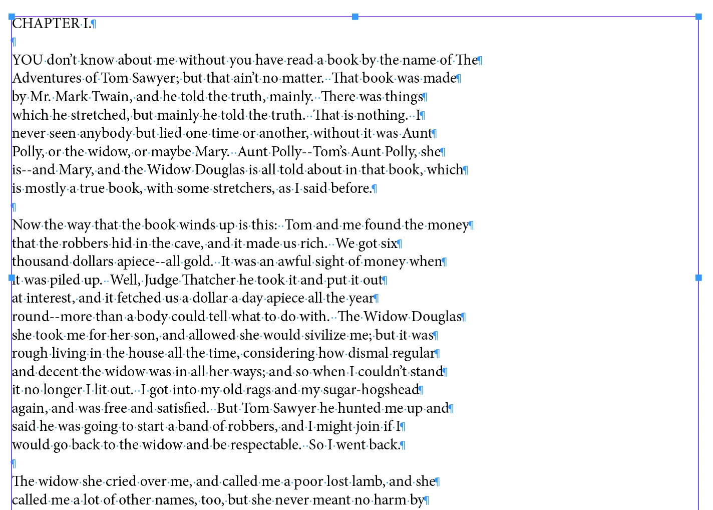

    Actually, all the content I looked at on gutenberg.org at has double returns ¶¶ between paragraphs, which makes the clean-up very simple.
    on gutenberg.org
    Pasted in InDesign:

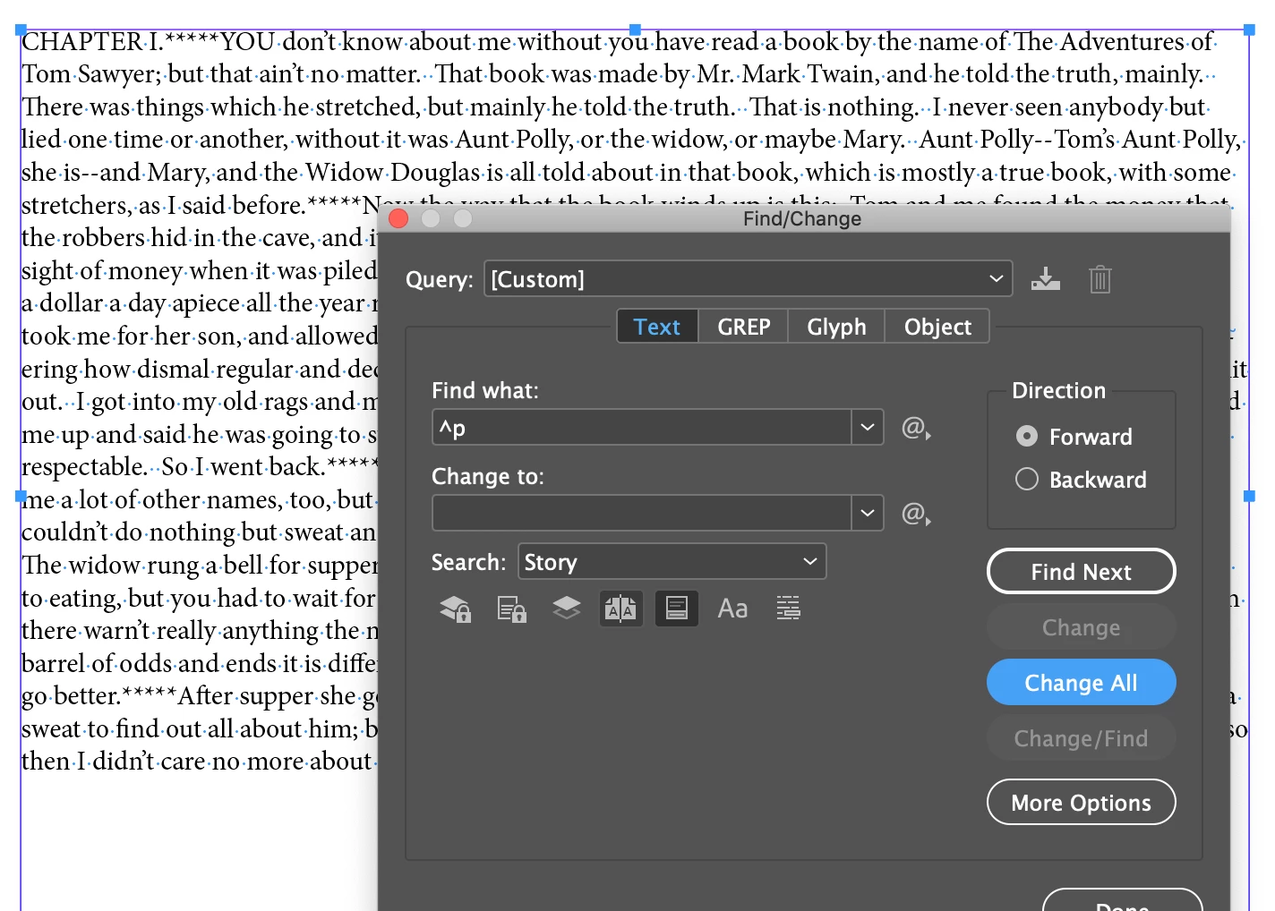

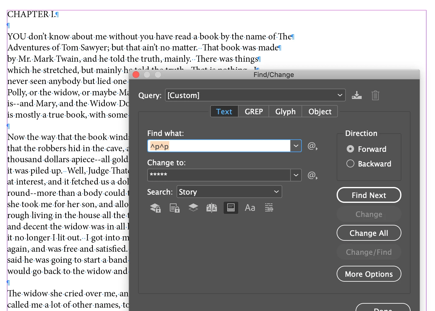

    Run three consecutive Find/Changes:
    Find: ^p^p
    Change to ***** (pick something that isn't in the file)
    Then
    Find: ^p
    Change to: [press the spacebar once]
    Finally
    Find: *****
    Change to: ^p
    ~Barb

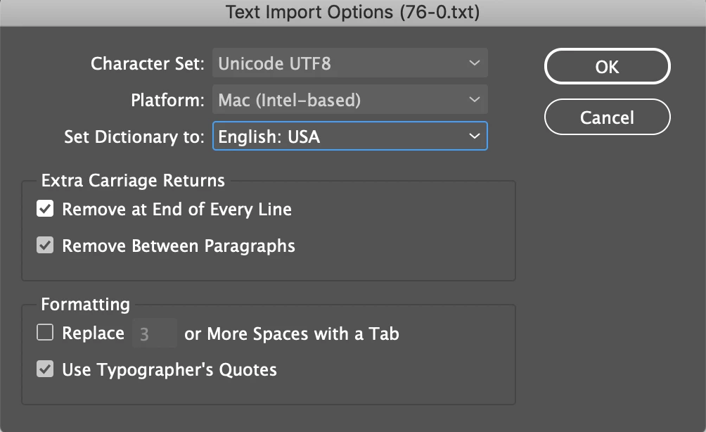

    > ... which makes  the clean up easy ...
    Isn't there an Import option for plain text just to fix this?
    Barb Binder
    February 28, 2019
    Turns out that's a yes, [Jongware]—but you knew that. I haven't imported a .txt file for so long it didn't even occur to me to check the import options. I just remembered what I used to do years before InDesign was a glimmer in PageMaker's eye.
    ~Barb

    February 26, 2019
