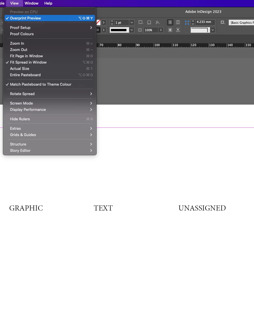

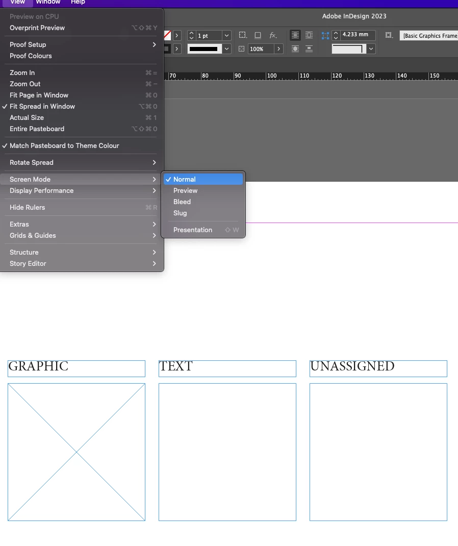

Oct 15, 2025 2:36 PM UTC
Couple of things could be happening
There are 3 frame types, Graphic, Text and Unassigned (as per below screenshot).
Ensure you have View>Extras>Show Frame Edges turned on
When in View>Screen Mode>Normal it should look like this
If you still cannot see the frame edges - then you should check
View>Overprint Preview when this is on it hides the Frame Edges
When this is on it hides the Frame Edges
