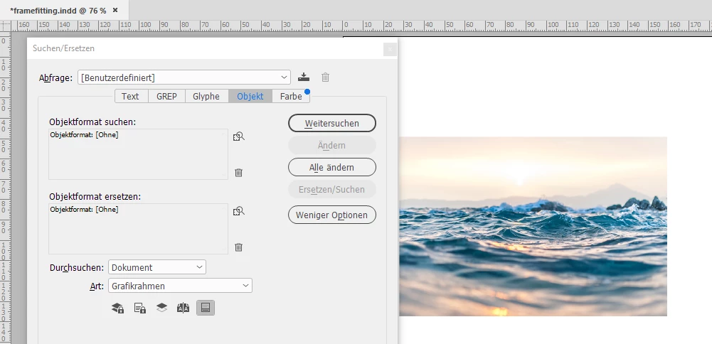

Hi Yuliya,
you can reset the frame fitting options of all objects with applied object style [None] this way:
Go to Object Find/Change.
Find all objects with object style [None] ( in my German version this is style [Ohne] ).
Change the found ones to object style [None].
You could restrict your found ones to Graphic Frames.
( In my German version this is option "Grafikrahmen". )
From my German InDesign on Windows 10:
Uwe Laubender
( Adobe Community Professional )

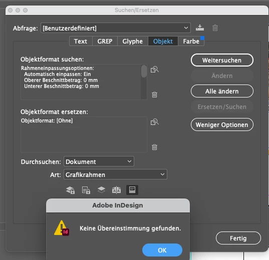

Thanks! Learned something new. I wasn’t aware you can target other things than text with Suchen/Ersetzen (also German here ;)). It did get quite a few pictures but I doubt it were the right ones. One time I have managed to catch a picture when I filled in the frame fitting options with the exact "Beschnittbetrag" but that seems to be different with every picture.

First I thought you might be right because I didn’t get this issue with a new document I created just now. I thought that if I change the settings it automatically should apply to all frames, also the already existing, if I didn’t change anything manually. So that makes sense and maybe it’ll work in new documents from now on.
But in the old one I have also changed the settings and still a new frame is using the frame fitting option. I isolated a new page for you.
