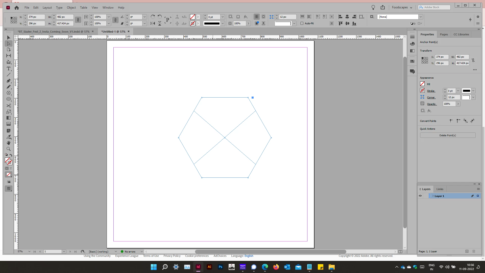

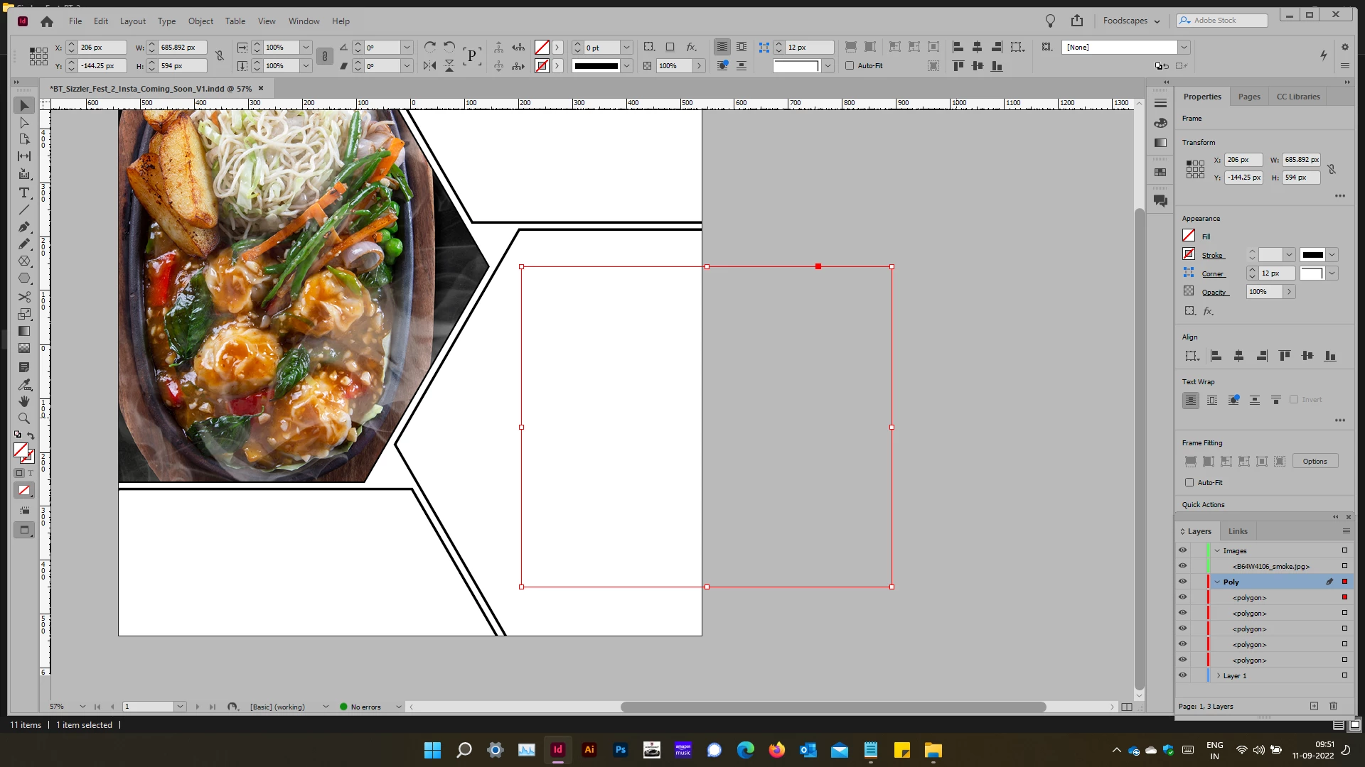

I was trying to do a polygon frame to place my image but for some reason it just shows as a rectangle.
Placing/aligning the image & frame to a place that I want becomes impossible.
Attaching a SS.
Vijay.

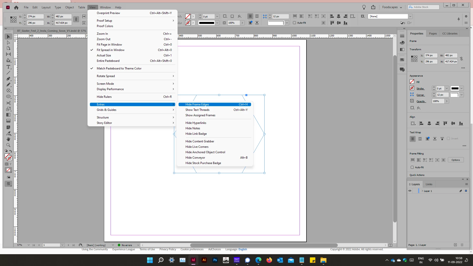

The polygon has been created fine but you have selected it using the wrong tool. Do the following and if you did use the polygon tool correctly you will see it.
  • Navigate to the followign menu path and switch on the Show Frame Edges option. View>Extras>Show Frame Edges. This should now show you the polygon boundaries instead of the bounding box that you currently see.
  • Select the object using Direct Selection tool, the 2nd tool in your toolbar and you shall select the frame edges instead of the bounding box that you currently have.

Frame edges is already selected. If I draw it in a new document it comes out fine.
Even when I don't use direct selection, it shows both.
