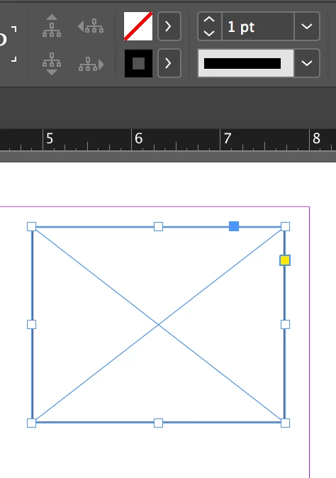

    Steve Werner
    February 16, 2018
    With no stroke weight, you wouldn't see the frame after drawing it in Preview mode.
    Did you have a stroke weight other than 0 pt selected when you started drawing? Are you drawing in Preview mode?
    You can change stroke weight and color in the Control panel (shown below) or in the Stroke panel.
    You can switch between Normal view and Preview view by choosing View > Screen Mode > Normal (or in the Screen Mode menu in the Control panel.
