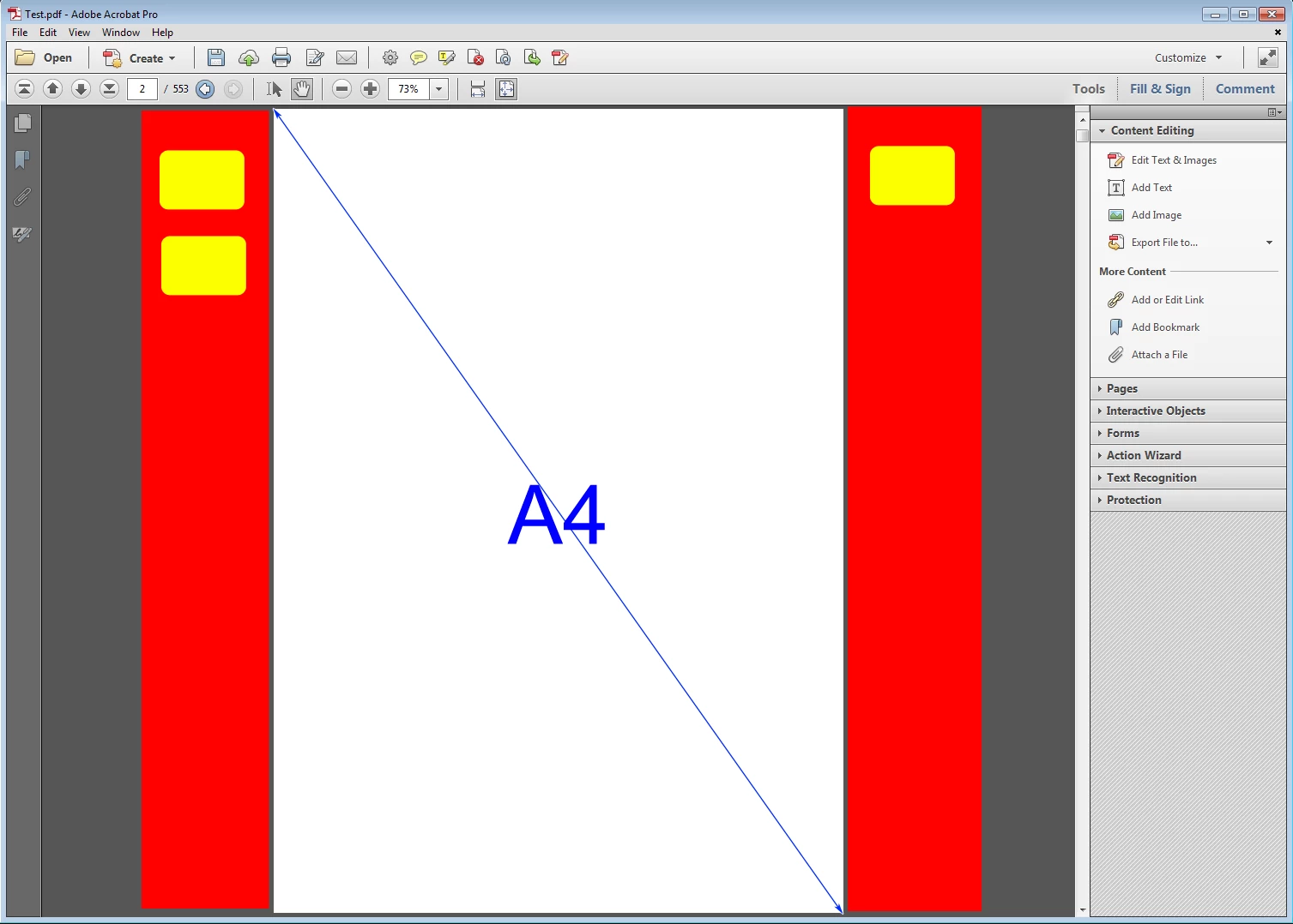

     I am looking at improving the manuals I create and I am trying to find out which Adobe program adds frames to the outside of the main page. I have seen manuals where outside of the A4 frame are frames either side (See the red area in the picture) where navigation buttons are added (See yellow in picture). These frames do not print, when printing only the A4 page is printed.  Is this Adobe InDesign or Adobe FrameMaker, or something else? Also what are they called so I can search for tutorials on how to create them.

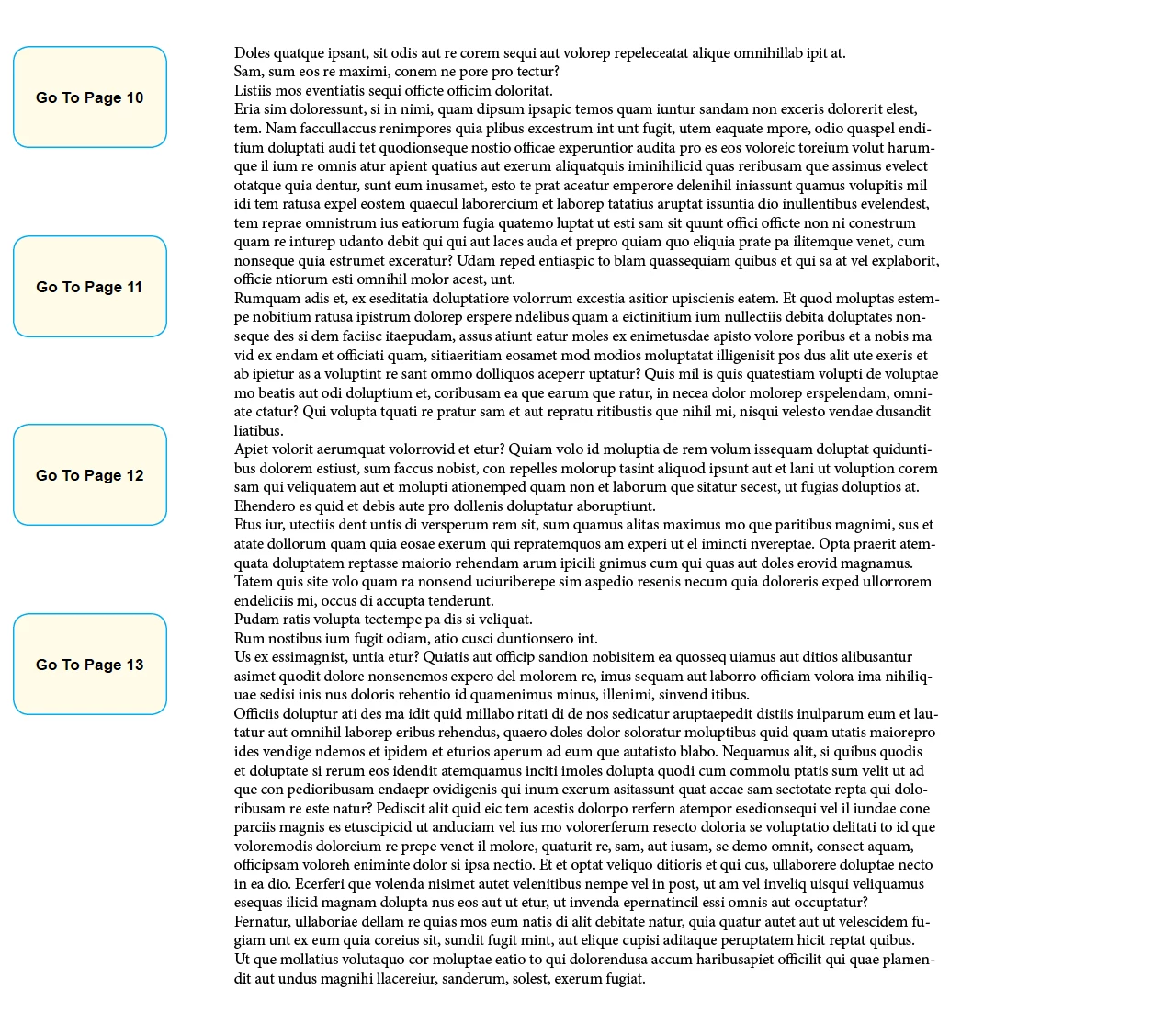

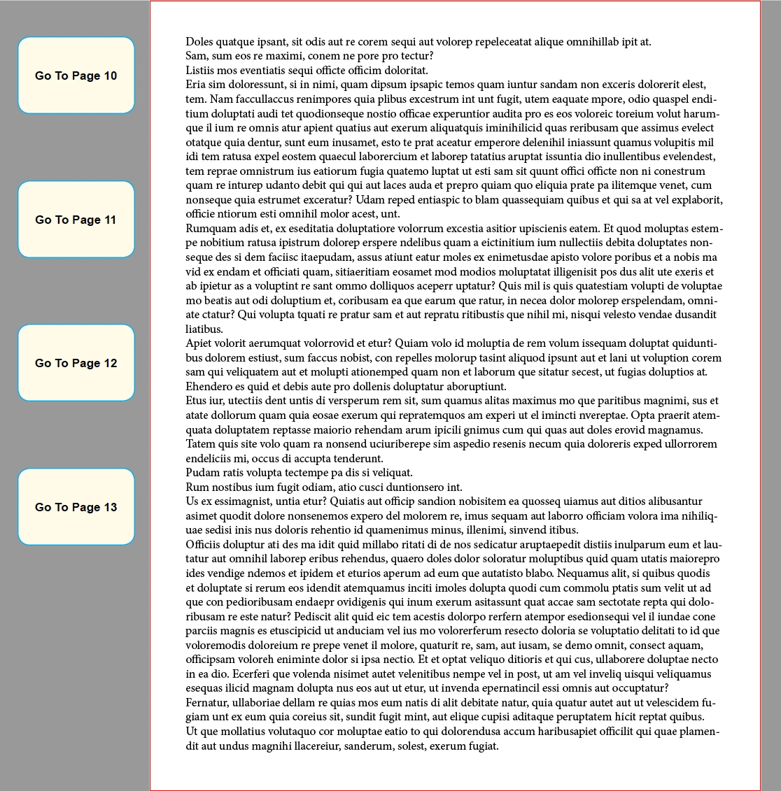

    You can create navigation buttons in InDesign and export as an interactive PDF. Unfortunately, I don't think you can include slug and bleed areas in an interactive PDF, but there is a work-around.
    Create your InDesign document larger than the desired final print size, e.g add 2 inches to the sides. Place your buttons on the expanded side areas and export to an interactive PDF.

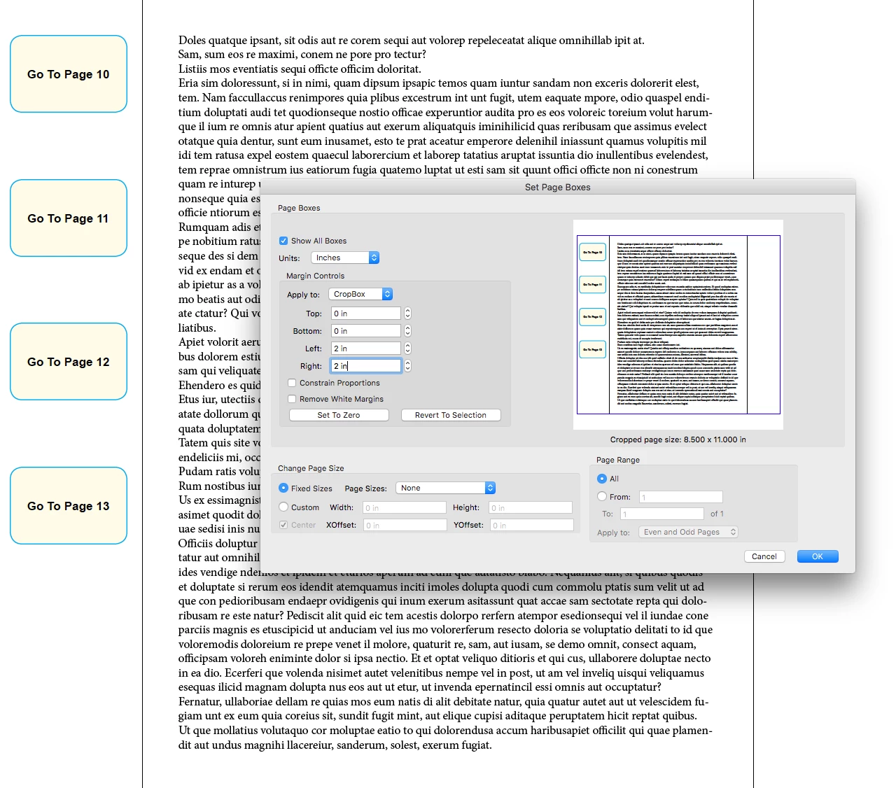

    Open the PDF in Acrobat and use the crop tool to reduce the crop box by 2 inches on either side, save.
    The buttons will remain viewable and active in the margins of the PDF, but should not print.
    If you place your buttons on a separate InDesign layer (and export to an interactive, layered PDF) you can turn the button layer visibility on and off in Acrobat.
