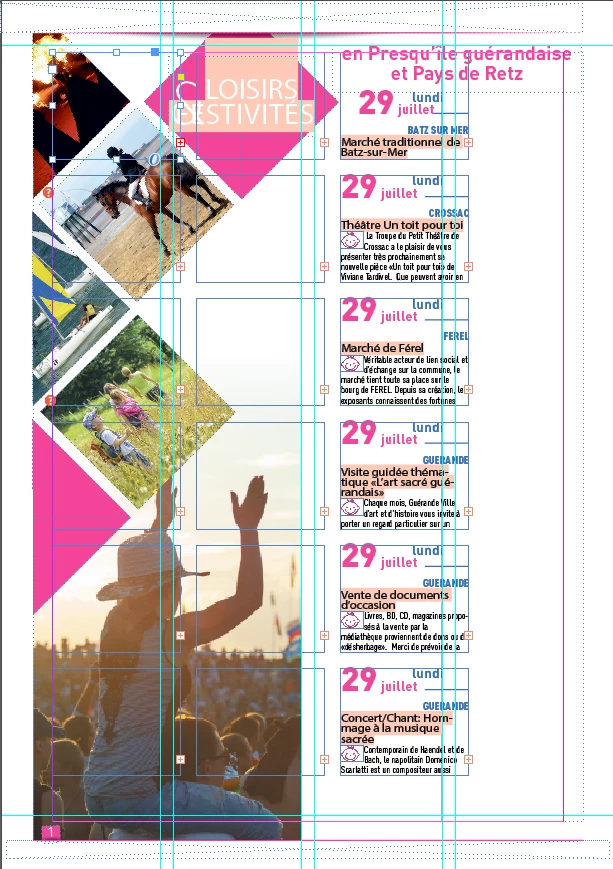

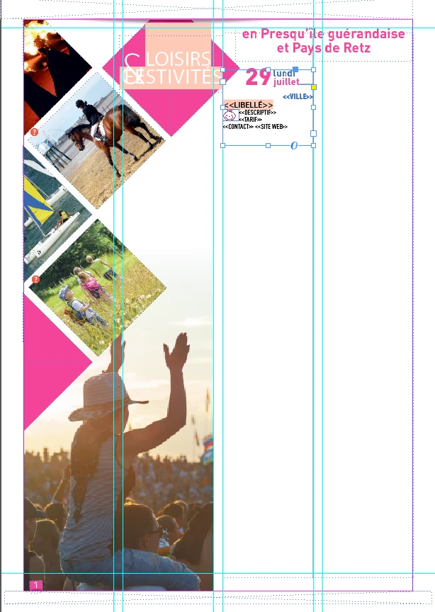

I'm having an other problem. I have different templates on my document and when I merge it adds to many text frames on the page,
Here is a picture before I merge :
And after :
Could help me ?

Colin Flashman
October 28, 2018
Hello again.

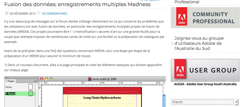

From my video, I'm basically saying that you can't merge the next record into the same text frame without merging the records and then combining the many text-frames that the merge makes, and that video outlines several ways that this can be done. I've written about this elsewhere: https://colecandoo.com/2013/12/28/data-merge-multiple-record-madness/
