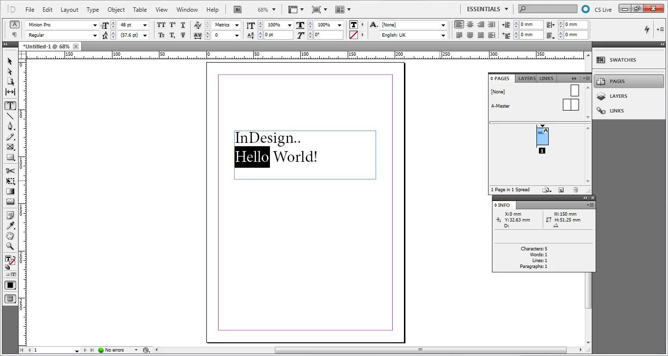

Thank you for replying, though I am sorry for responding so late. What I want could be better explained by the screenshot below:
Here you can see that there is a text frame in this document. The text 'Hello' is selected in the text frame. I want to get the coordinates/bounds of the four corners that cover the word. In other words, the coordinates/bounds of the selection.
How can I get this?
What you suggested returned me the whole text frame. But I want the coordinates or bounds of the sub-text.
October 21, 2013
You can try as below:
mySelection = app.selection[0].createOutlines(false);
myBounds = mySelection[0].geometricBounds;
mySelection[0].remove();
alert("myBounds: "+myBounds);
