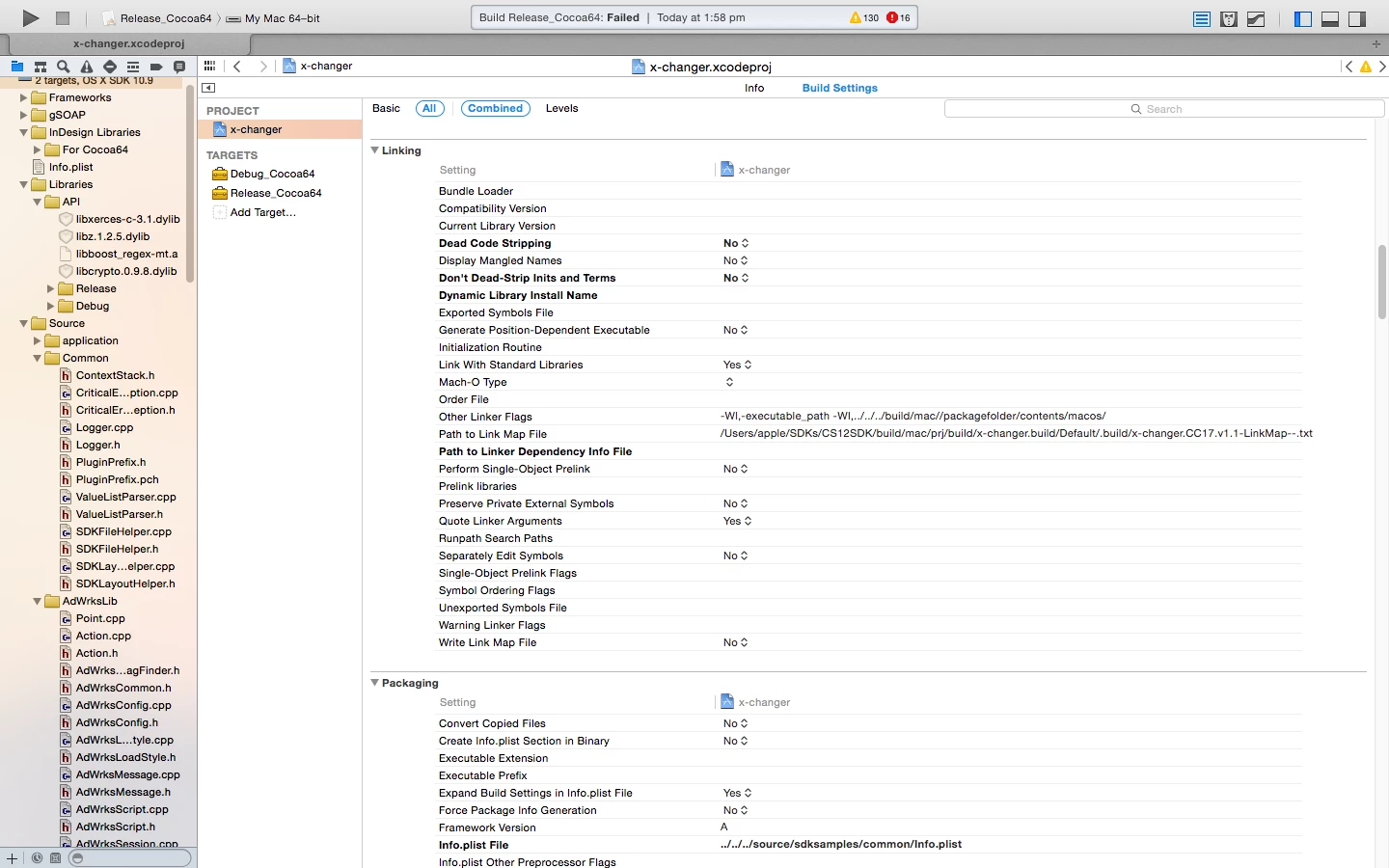

My Linking Section in Build Setting looks like in the following image.
I would really appreciate some help here. Thank you.
