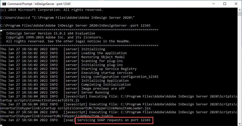

I started an instance of InDesign Server on a SOAP port from Command Prompt
  1. cd "C:\Program Files\Adobe\Adobe InDesign Server 2020\"
  2. InDesignServer -port 12345
And now I have it up and running:

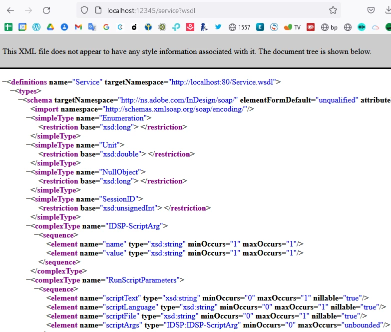

I navigated to http://localhost:12345/service?wsdl and IS responded to the SOAP request:

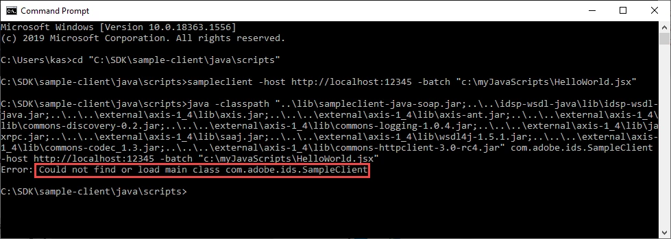

  1. cd "C:\SDK\sample-client\java\scripts"
  2. sampleclient -host http://localhost:12345 -batch "c:\myJavaScripts\HelloWorld.jsx"
This resulted in an error: Could not find or load main class com.adobe.ids.SampleClient

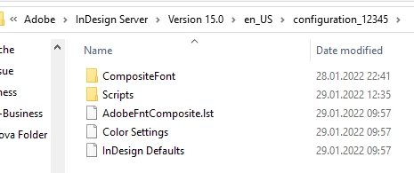

But there's no Scripting Support folder:

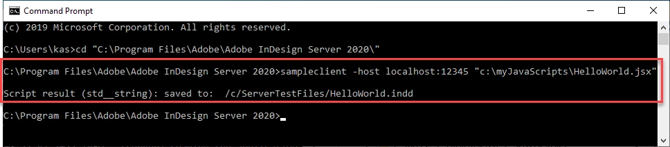

Now I can run the scripts both from ESTK and command prompt:
Thank you, guys!

I don't have access to WIN machine with IDS installed at the moment but if I remember correctly the path to the sampleclient application is not correct. Look for sampleclient inside the IDS installation directory. Something like the following
And the command to run the script would be(I am not aware of the -batch argument)
sampleclient -host localhost:12345 yourScriptPath
Regarding debugging using ESTK, look for the entry with your SOAP port listed. Using the Adobe InDesign Server 2020 application does hang, I have faced this as well. If you don't see the entry with port in the target then try to execute a script with a $.writeln call using sampleclient that should hopefully sort the issue.

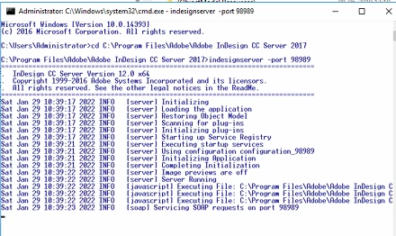

Can you share me screenshot of "select target application" dropdown of ExtendScript after start indesign server?
I work daily with these commands and it work perfectly.
STEP 1: Launch ExtendScript Toolkit
STEP 2: See select target application there is no instance.
STEP 3: Open command prompt.
STEP 4: change current directory an run indesign server.
STEP 5: Now change "select target application" as new instance of indesign server.
STEP 6: Run you script and check output.
