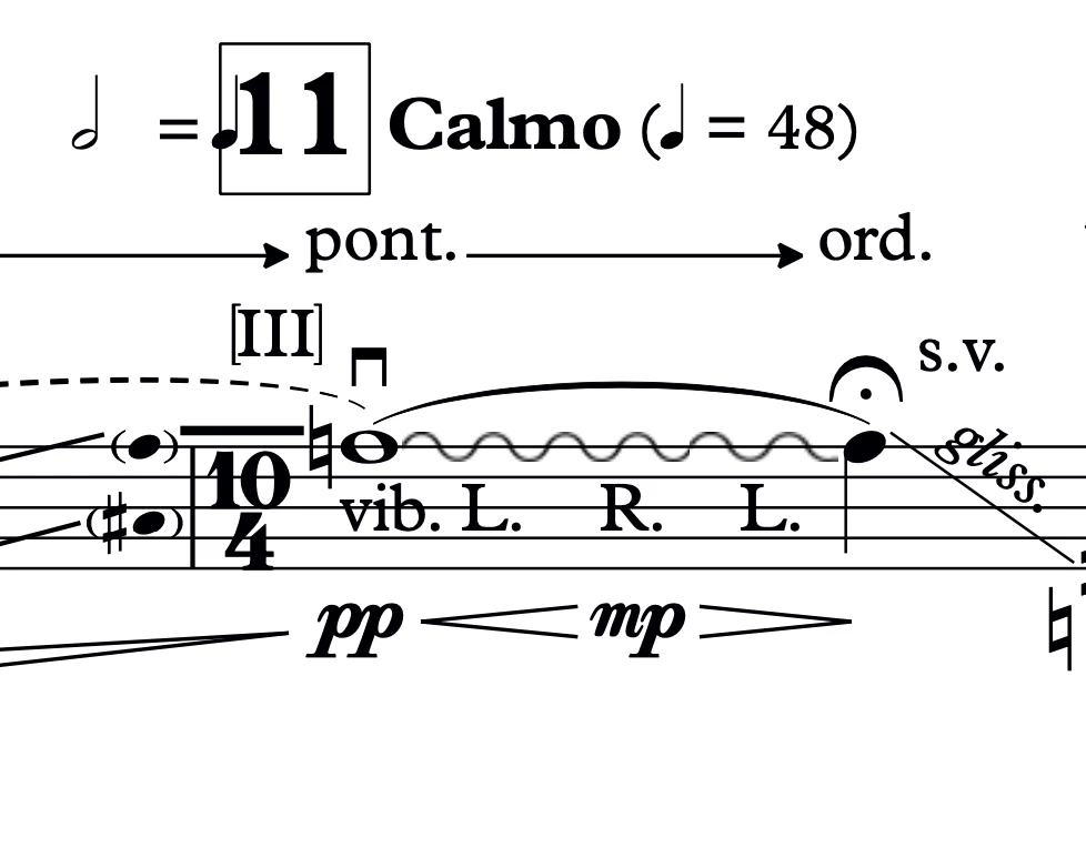

In the last page of music, second-to-last system, there is a metric modulation in the form of half-note equal quarter-note. In the PDF exported from Sibelius it shows fine, in InDesign after import it shows fine, in the exported PDF it shows as this, with the equal sign overlapping the quarter note glyph as a result of being offset to the right:

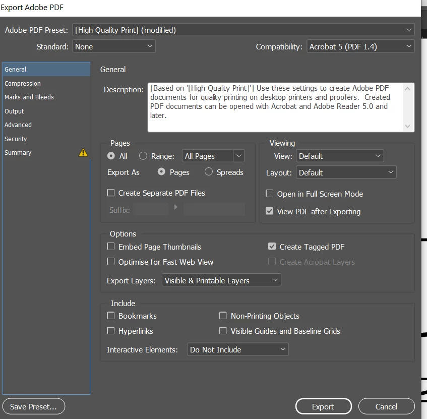

I tried different PDF presets, from 1.3 to 1.7, with no appreciable differences.
