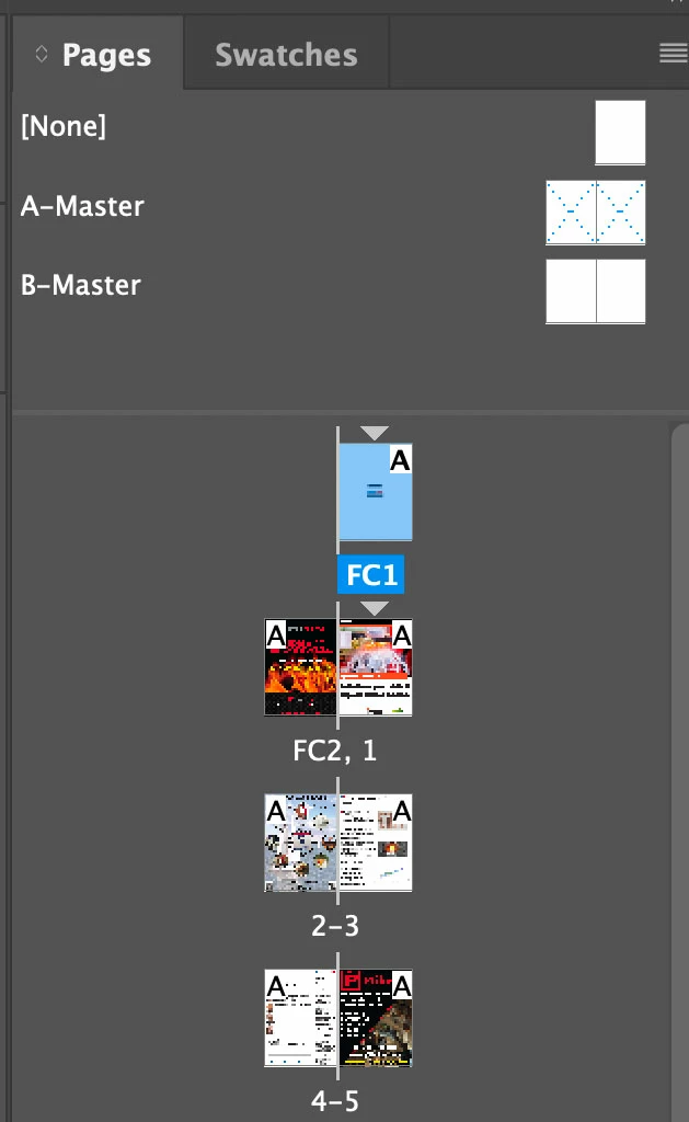

    The Go to Page number is the number relative to layout, not the numbering section applied to it. In screenshot, if I wanted a button with "Go to Page" to travel to numbered page "3", I would enter page "5", because this is the fifth page of the layout.
