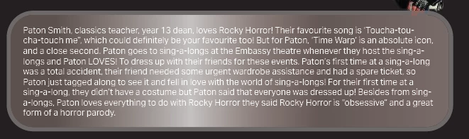

    Jul 6, 2026 7:37 AM UTC
    This is what the brown textbox looks like, i’ll reply with a picture of what its meant to look like
