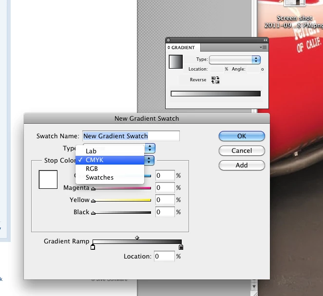

Just designing a two-color gradient in CS5 InDesign is headache enough...click on Swatches control panel, see that there is no "New Gradient Swatch" button at the bottom (despite what the books and online help say), click the microscopic menu at the upper right of the panel, select "New Gradient Swatch", only to find that there are only two choices - Linear or Radial - and fiddle with every feature in the window to finally get the color range you want.
Frankly, five very expensive versions of Creative Suite later, I am both amazed and disgusted at the fact that:
- There is no horizontal gradient, only "Linear" (and that is vertical; that is, each color within the range goes top-to-bottom; the range itself is left-to-right)
- There is no seeming way to get a horizontal gradient, or a vertical gradient with the colors reversed. InDesign decides the orientation and polarity (in this instance, dark (left) to light (right) ) of your gradient
And before anyone launches into a lecture about the Window > Color > Gradient option, I already tried that. I don't know what your copy of CS5 InDesign displays on your system, but on mine, that window has no OK button. In other words, you can play around all day long with the Window > Color > Gradient window but you cannot apply what you've settled on to your current project because there is no way to tell the program that "OK, I'm done, please apply the options I've selected to my project or selected swatch."
So, tell me truly, how can a newly-bald user design a simple two-color gradient that has vertical range, where lightest color is at the top and darkest color at the bottom?

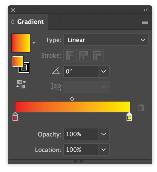

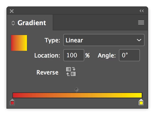

    It's almost identical between InDesign and Illustrator. INDESIGN below:
    ILLUSTRATOR below:
    Steve Werner
    May 5, 2017
    Incidentally, Illustrator came first, and InDesign copied Illustrator's Gradient panel interface to make it familiar to Illustrator users.

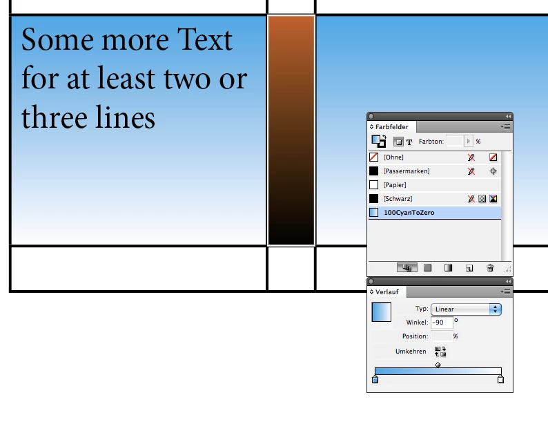

    @Grebe – I think, you are wasting your time (and losing your mind), if you want to control gradients in table cells.
    Apply a gradient to a cell, use the Gradient Tool to make it 90° from top to bottom. Everything is looking fine.
    Then add some new table rows below. Blam! The gradient fill of untouched cells has changed.
    Step 1 of going mad with gradients in table cells; everything is looking perfect after dragging the Gradient Tool from top to bottom of a selected row using a gradient from 100 Cyan to 0 Cyan:

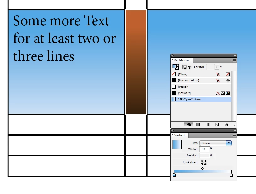

    Step 2: The same table just after adding two rows below (Arrrgh!):

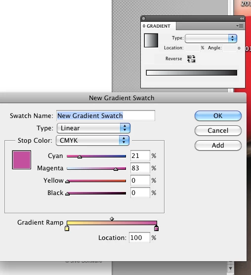

    It's not really that hard. To make a new gradient Select New Gradient Swatch from the Swatches flyout. You should get a dialog that looks like this
    When you click on one of the gradient stop at thebottom of the ramp you will activate the ability to choose a color for that stop in the color mode you want
    If you choose CMYK you can mix the color or you can choose Swatches and choose from existing swatches in the file.  This is how it looks with both selected
    When youOK the dialog a new swatch is added to the Swatch panel. You can apply it by drawing or selecting an object in your file and making the fill box active . It should look like this

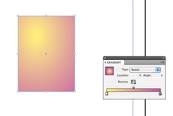

    In the Gradient window shown to the right of the object you can change the angle by using either the Reverse button or the angle window like this
    Or you can use the Gradient tool from the tool box to drag across the gradient to change it as you want
    If you want here's the difference in a radial gradient changed with the gradient tool from the tool box

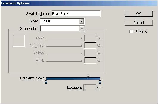

    What I tried to communicate in my original post was that in this window:
    There is no way for me to make the changes I make in this window show up in the document. Where is the OK button? I really, really tried. Everything. I switched the Angle. I played with the Reverse. Nothing I did reflected itself in the actual document or the swatch.
    So what am I missing here?
    Incidentally, when the Gradient Options window is open:
    The smaller window is inaccessible. I have to close the Gradient Options window to do anything in the smaller window, and like I said, anything I do in the smaller window does not manifiest itself in any way in the document or the swatch.
    It's one thing to tell me "You can change the angle, you can reverse the flow, etc." but how do I tell InDesign to take what I've selected and actually implement it in the document or swatch?
    Three different books on CS5 InDesign couldn't provide the answer, either.
    Peter Spier
    September 14, 2011
    You can't make those changes to the swatch itself. You make them to a selected object.
    So, if you select an object and apply the gradient, then open the gradient panel, any changes you make will be reflected in the selected object. You can also set the gradient angle as part of an Object Style definition.
