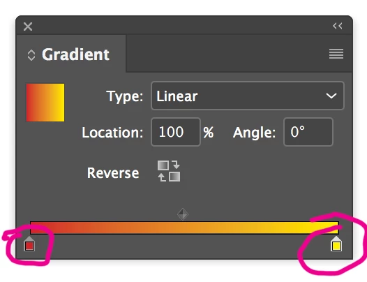

    It's almost identical between InDesign and Illustrator. INDESIGN below:
    ILLUSTRATOR below:
    Steve Werner
    May 5, 2017
    Try actually using those windows you took a screenshot. Click on the colours. Trust me I did learn how to use them which is why I ended up ranting here. The fact the windows look the same is WHY they are confusing. It implies they should function in a similar way. But they don't. It's not the end of the world. But it is confusing.
    I teach both InDesign and Illustrator classes. Illustrator has been around longer (since 1987!) than InDesign. And it's used more for gradients then InDesign is. The Illustrator team has added some additional enhancements for the Gradient panel and the Gradient tool that the InDesign team has not. That's the main reason they differ. Hang in there!
