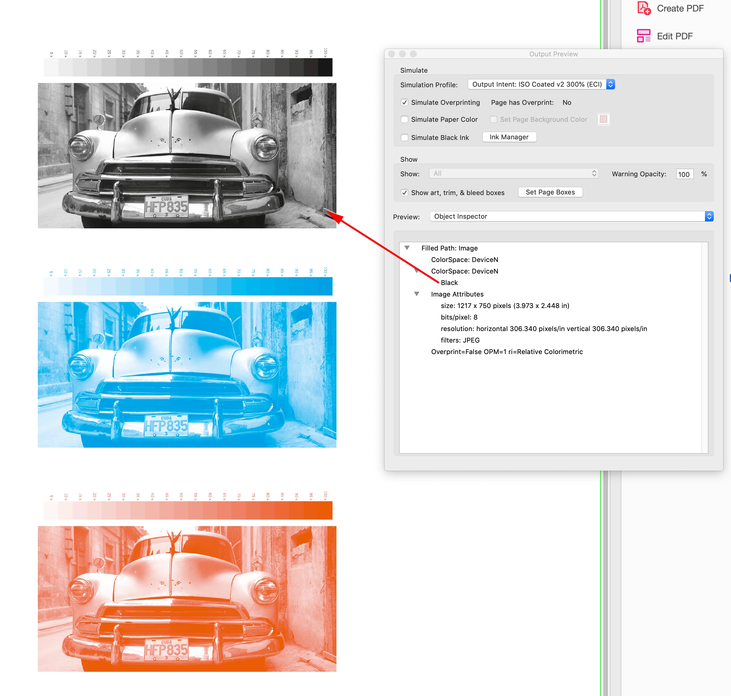

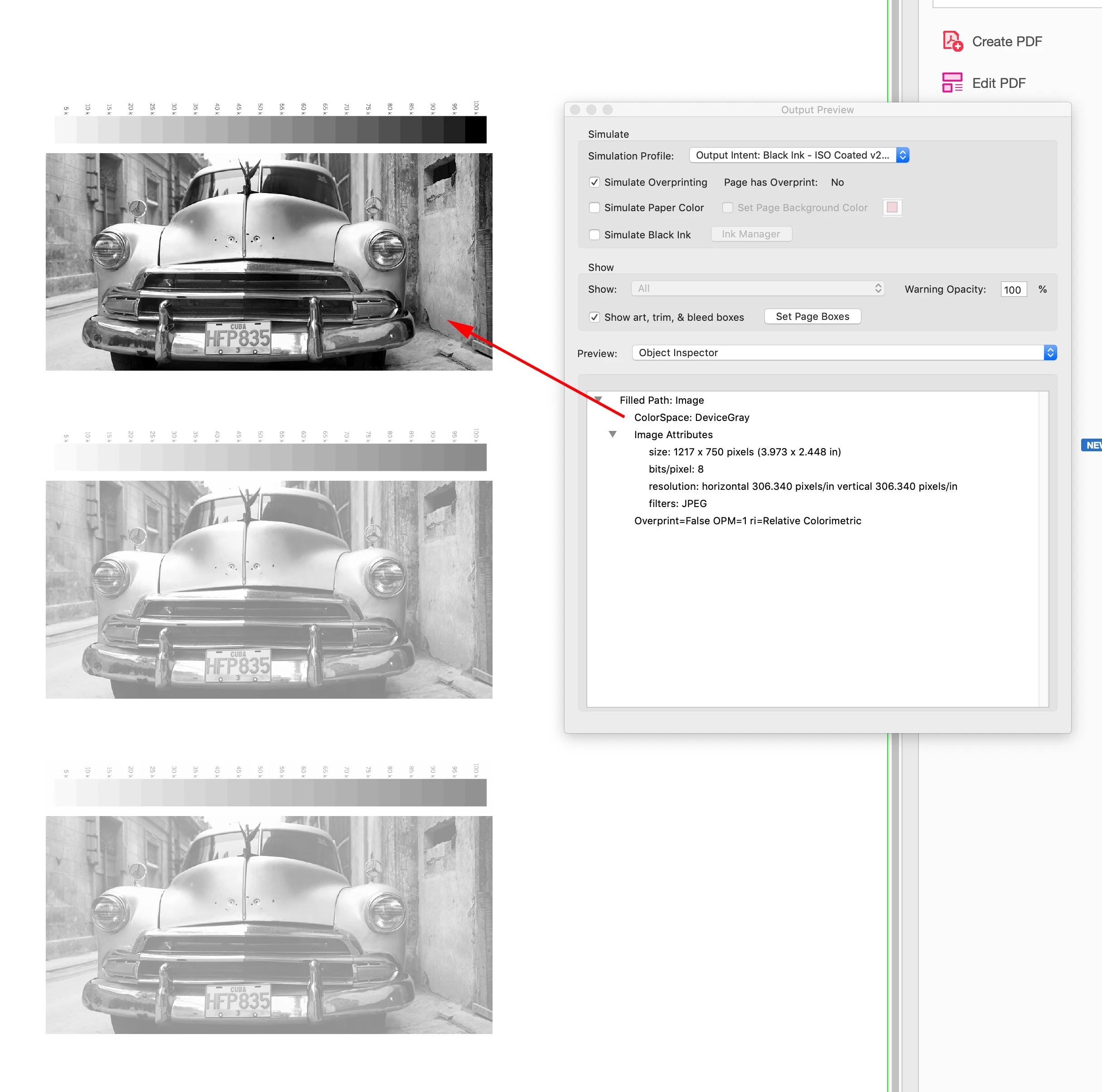

A grayscale that is not flattened in photoshop cannot be assigned a color and exports on the Black plate as DeviceN when No Color Conversion is chosen. When the grayscale is flat it can be assigned a color and if the assignment is [Black] and the export is No Color Conversion, I would get DeviceGray, while a conversion to Document CMYK would be DeviceN Black. It’s important to note in all of those cases the original Grayscale values are exporting to the Black plate unchanged—there has been no conversion of the gray values.

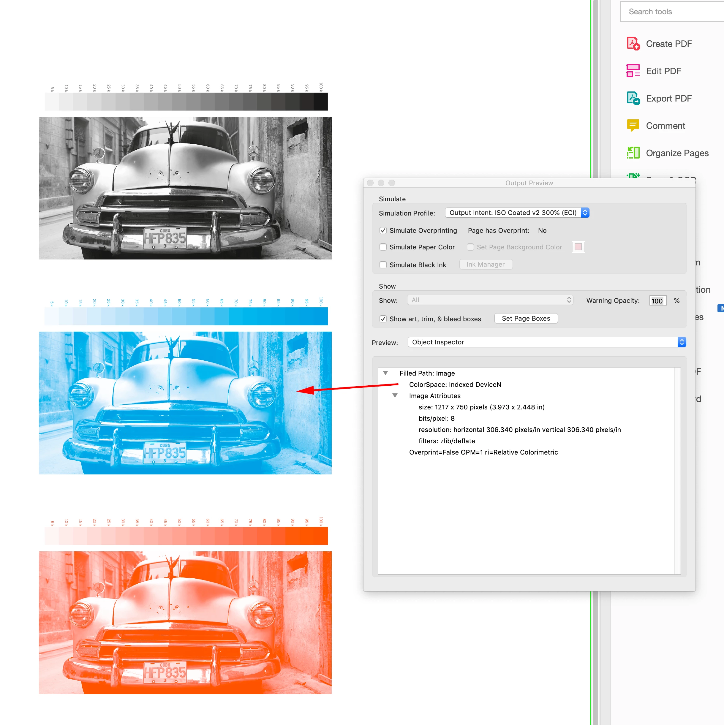

If I Export the flat grayscale to Document CMYK the top version set to [Black] is listed as DeviceN Black—again all of the gray values are on the Black plate unchanged. The blue version in the middle has a process color assigned and could have values on any of the 4 plates, so it is listed as Indexed DeviceN (256 shades of the blue color)

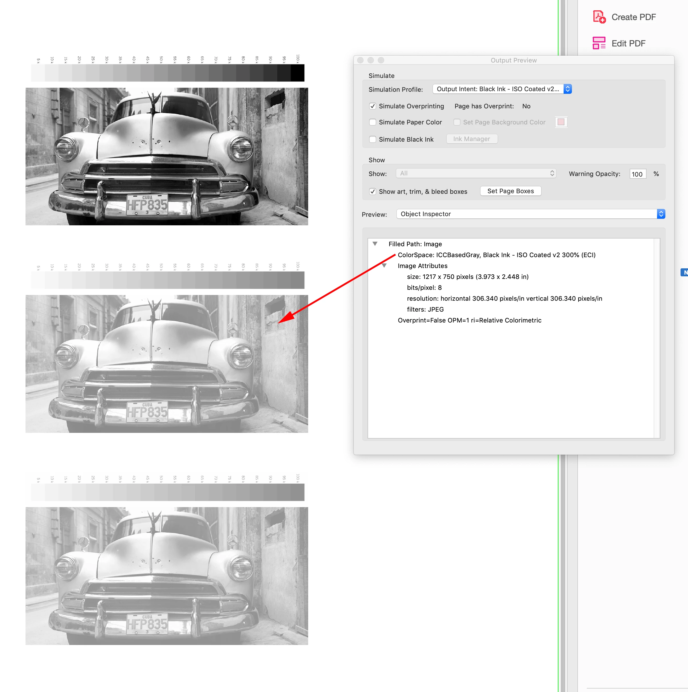

An Export to a Grayscale Destination would list the top version as DeviceGray and the colored versions as ICCBaseGray indicating the conversion of the CMYK colored images to the chosen gray space

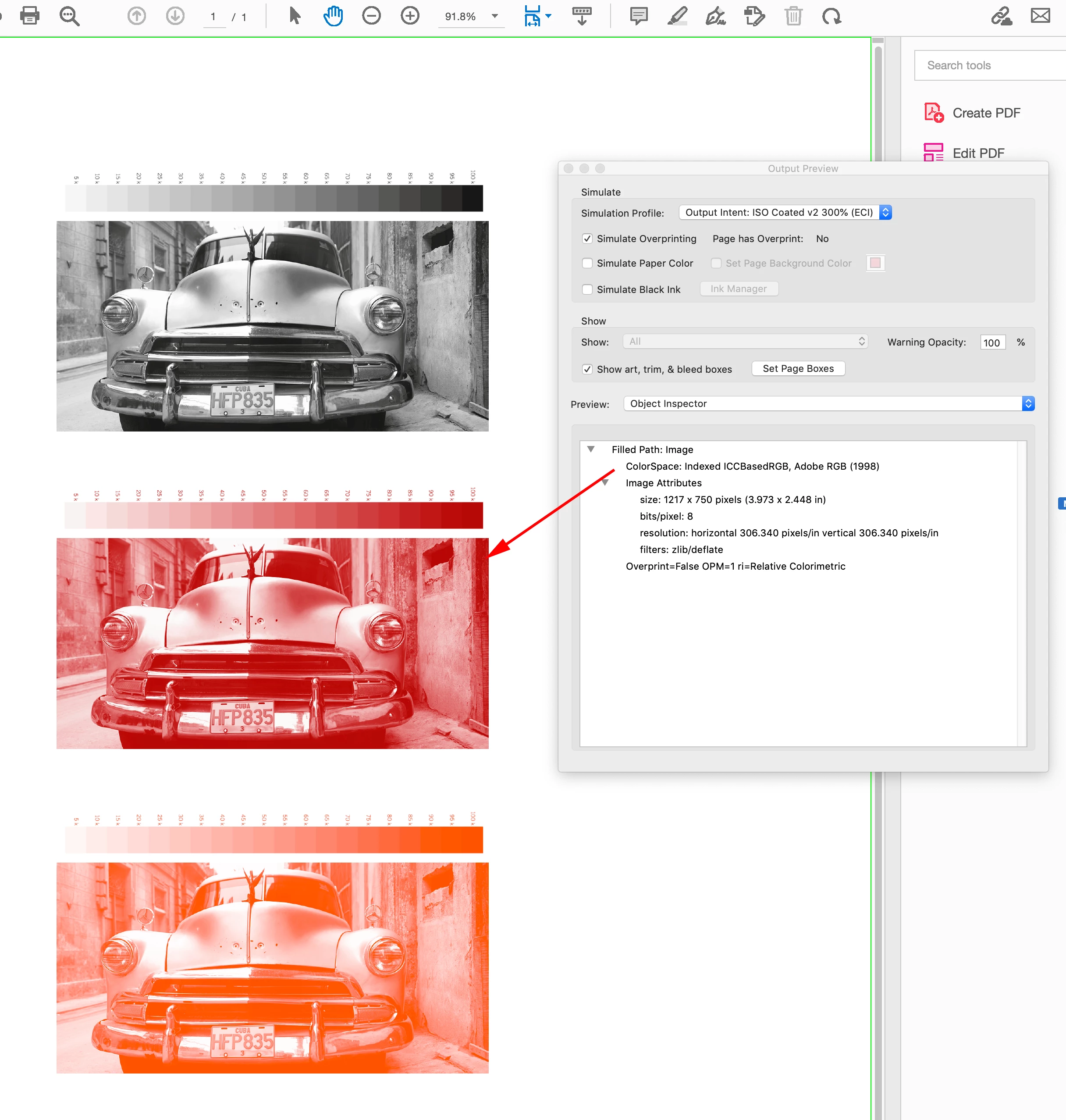

Also, the PDF/X-3 Standard allows profiled RGB objects, so if you assigned an RGB process color you would get Indexed ICCBasedRGB:

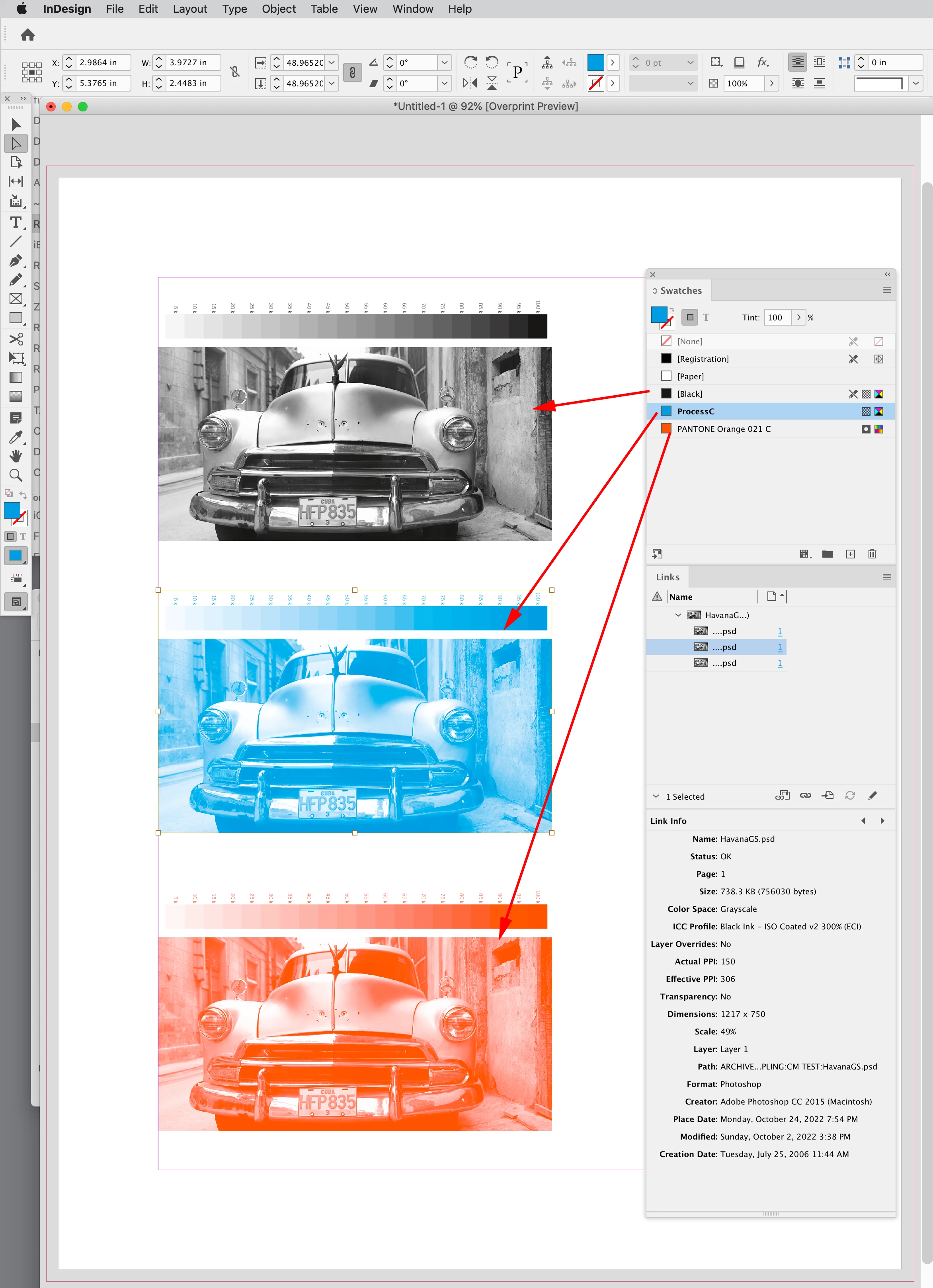

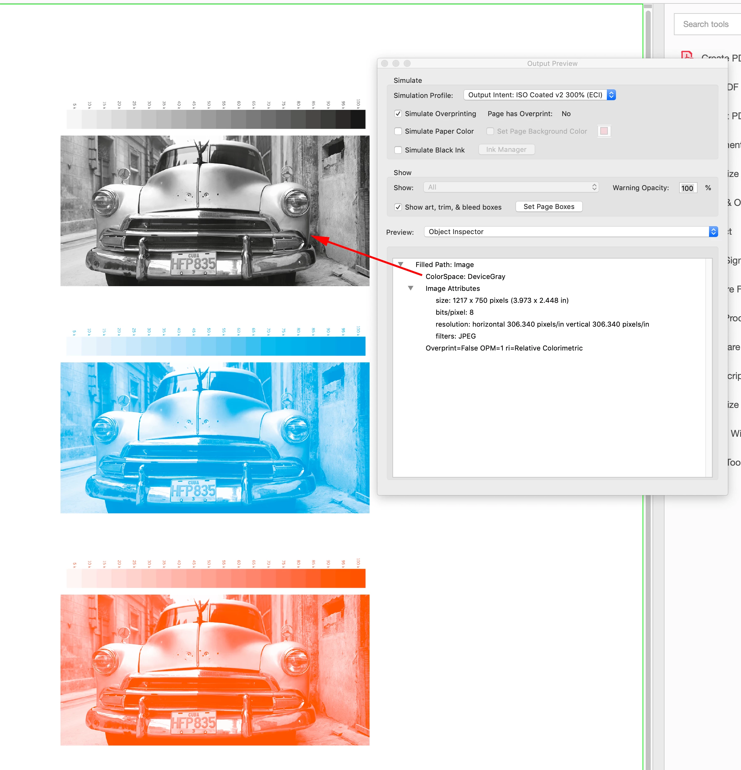

Hi @sd5e8a , It’s DeviceN because InDesign lets you assign any color to a flattened Grayscale (a Photoshop Grayscale with a flattened Background Layer). Here the same placed grayscale is assigned the default [Black] swatch, a process CMYK color,  and a Spot color :

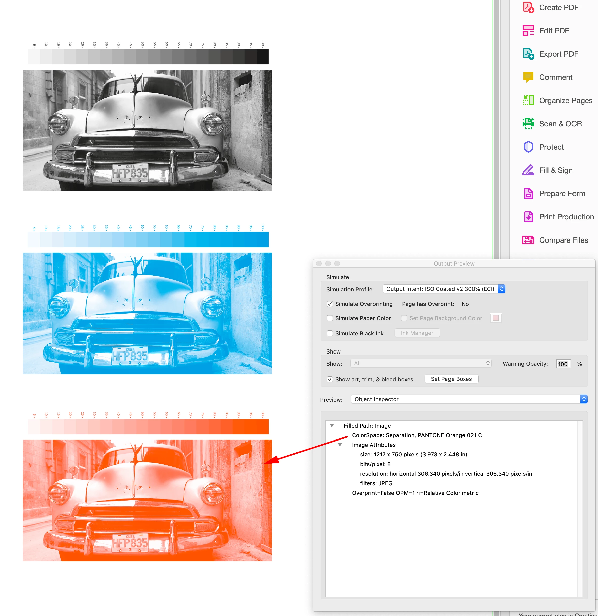

The color spaces on an Export to PDF/X-3 with no color conversion depend on how the grayscales were colored in InDesign—DeviceGray if CMYK Black only was assigned, Indexed DeviceN if a process CMYK color was assigned, and Separation if a Spot color was assigned:

Right, you’re not using it, but it’s an important feature, and DeviceN color space distinguishes how the "color" was handled on export.

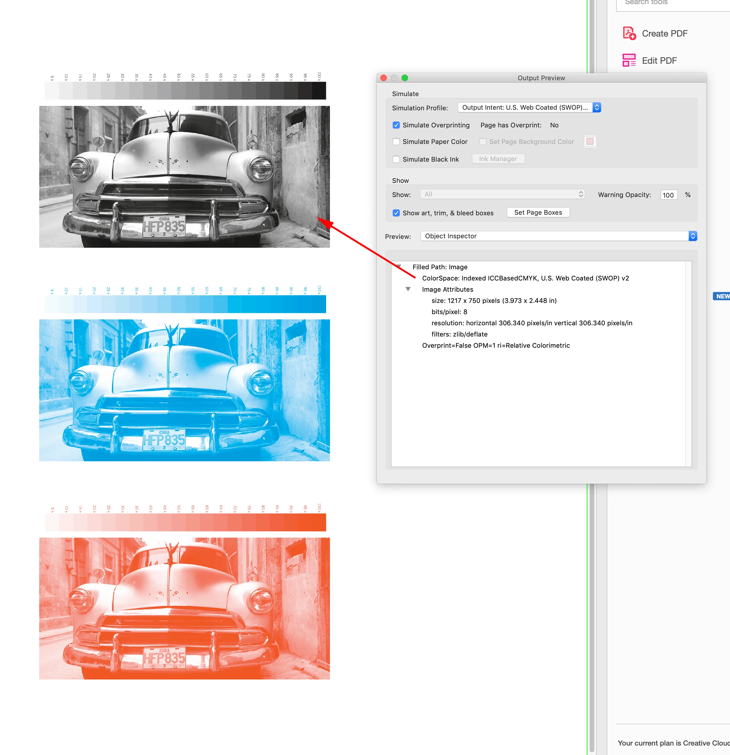

If I Export to a CMYK Destination that conflicts with DocumentCMYK, I get Indexed ICCBasedCMYK indicating that the original gray values have been converted to 4-color CMYK
