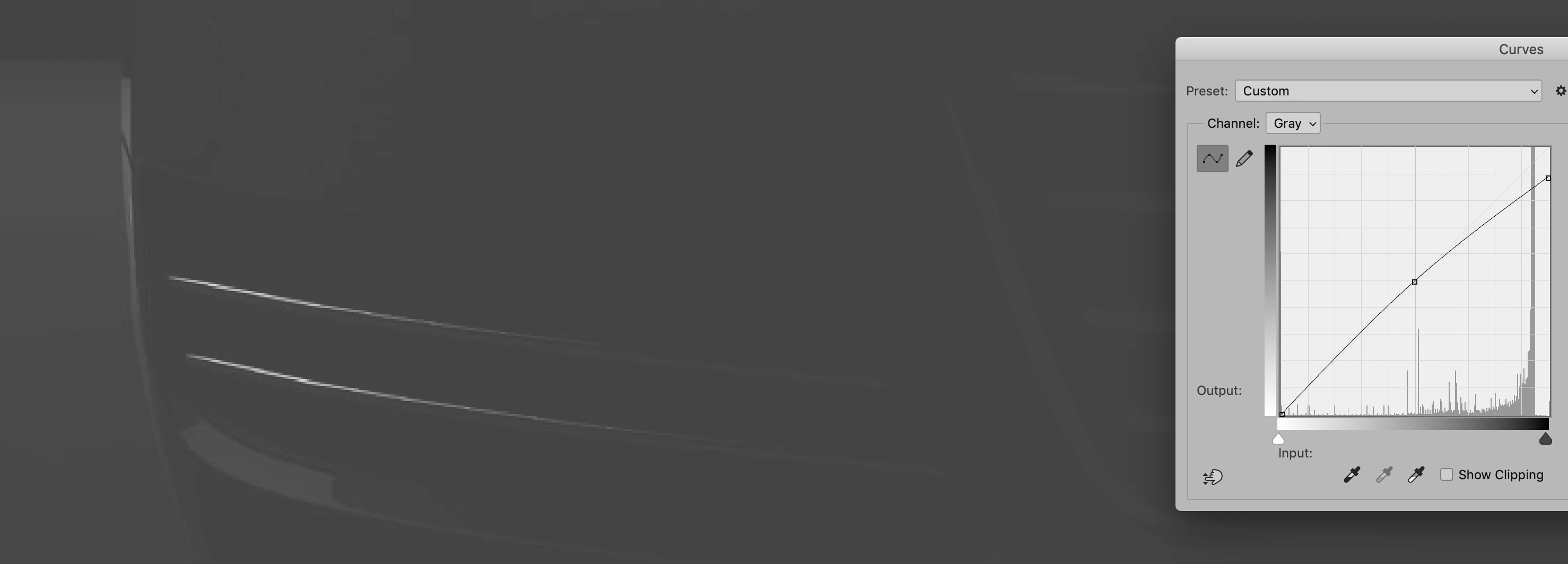

Thanks so much everyone, again. As a rule of thumb, I usually know I'm printing on uncoated paper, and that's about it, but as an approximation, is it reasonable to soft proof in InDesign / Photoshop for greyscale using dot gain of 20–30%, rather than the uncoated CMYK equivalent (if it's not going to be printed on CMY plates)? Results are quite drastically different in overprint preview when I'm looking at greyscale images using dot gain vs e.g. PSO Uncoated v3, which I hadn't realised – is the dot gain preview going to be the more realistic of the two, and the dot gain using a curve like the one @rob day suggested even more accurate for my type of setup (with all the usual provisos of course)? I'm still unsure why printers are asking me not to print at 100% K, since you're both using that in your profiles, but @reproo2773183 is I think right that they may be increasing density for print here.
The series of images I had to use this severe curve on, had large areas of detail between 85 and 100  similar to Rob's bottom left corner of the Car Radiator Grille. All these images were solid black at the edges and at on solid Black background objects so I had to leave my 100% point at 100%. If I hadn't had to hide the edge of the image against the background I'd probably of gone with a curves adjustment similar to below.
At this point I'm ignoring what I'm seeing on screen and trying to make the print on press look like it did before the curves adjustment. I'm using the eyedropper to try and get those high 90s to high 80s.
Maybe Rob's custom Dot Gain curve is the way to go for simulating print on screen but how would you go about fine tuning it for the print process? And how would it help outside of Photoshop or Downstream?
