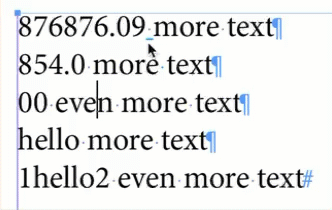

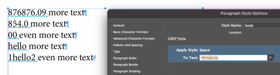

I'm trying to target the first space in a paragraph (assigning a blue underline for now).
Why does this match everything through the first space:
^[^\s]+\s

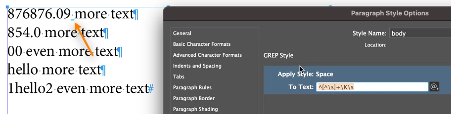

But adding the lookbehind only works on the first one in the text frame?
^[^\s]+\K\s
What fundamental Regular Expression concept am I missing?

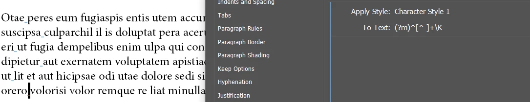

Alright, imagine you have a bunch of lines written down on paper, like a list. Each line has some words on it, and some spaces between those words.
This GREP (?m)^[^\s]+\K\s, is like this:
You go through each line, and when you find the first word on that line, you put a special mark after it.
Then, you look for a space after that special mark.
So basically, you're just picking out the space right after the first word on each line.
Your GREP:
^[^\s]+\K\s, is a bit simpler.
You look at all the words on all the lines together, not one line at a time.
You find the first word in the whole bunch, put a special mark after it, and then look for a space after that mark. So here, you're just finding the space right after the very first word in the whole list.
So the difference is like looking at each line separately for the first one
and looking at all the lines together for the second one
Hope that is clearer
Your GREP:
April 15, 2024
GREP is a logical construction. And you might think it's logically looking at the start of each line using ^ but it's a bit deeper and GREP has single line and multiline modes.
By adding (?m) as a flag at the start it works
(?m)^[^\s]+\K\s
(?m): This is a flag that enables multiline mode, allowing ^ to match the start of lines in addition to the start and end of the string.
The expression ^[^\s]+\K\s starts by matching the beginning of the string (^) and then captures the first word on the line ([^\s]+).
The \K sequence resets the starting point of the reported match to the current position, effectively excluding the first word from the match. Finally, \s matches any whitespace character after the first word.
This means that when the regular expression engine encounters a line of text, it matches the whitespace character after the first word. Since it doesn't capture the first word itself, it appears as though the expression is "skipping" the first word and the whitespace immediately following it.
Another reason it may seem like the expression is skipping lines is that it only operates within each line of the text. It doesn't explicitly account for line breaks or consider the content of subsequent lines.
So, after matching the whitespace following the first word on a line, the regular expression engine moves on to the next line without any specific instruction regarding what to do next. This behavior might create the impression of skipping lines, especially if the intention is to process each line individually.
The goal is to process every line so you need to qualify your GREP with an additional instruciton (?m) flag so it has instruction.

I just noticed you were trying to do this as a GREP style. I was using Find/Change, so let me see if I get differnt results with the style...
Peter Spier
April 14, 2024
OK, still works in CS6 as GREP Style, but now only affects first paragraph in story thread in v 18.

April 14, 2024
I think it's a bug.
^[^\s ]+\K\s works perfectly in CS6, but in Version 18 (I don't have 19 installed) it finds every second paragraph after the first on my system.
