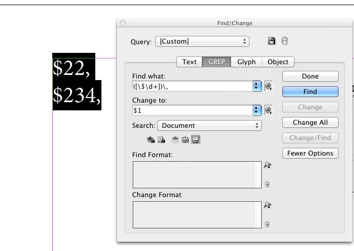

In Grep Pallette, use the below syntax to find  two or multiple digit dollar figure followed by a comma text,
Find what:     (\$\d+),
Change to:     $1

Thanks, that worked perfectly. But here's what I don't understand: when I did change "\$\d\d," to "$1" it just replaced with the actual string "$1", but when I used your method, it worked fine. Apart from the difference in the 'find what' string, what makes your method work?

Hi Luke....,
see the screen shot & try ....
thanks
shil...
