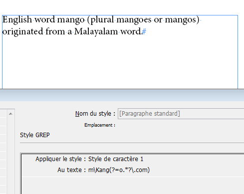

June 7, 2019
Yeak \K is Kool...
In your specific case, it does nothing more than a "classical" positive lookbehind, (just shorter to write ^^) but its real power lies in the fact that it can deal with quantifiers (+ * ? etc.)
About your latest regex m\Kang(?=o.*\.) please note that it will catch (m)ang(o) even in classical sentences which ends with a dot.
Even plurals.
Maybe it's fine for you, but be aware of it...
By the way, you don't even need the .*\. part then ^^ m\Kang(?=o) would do (almost) the same job.
