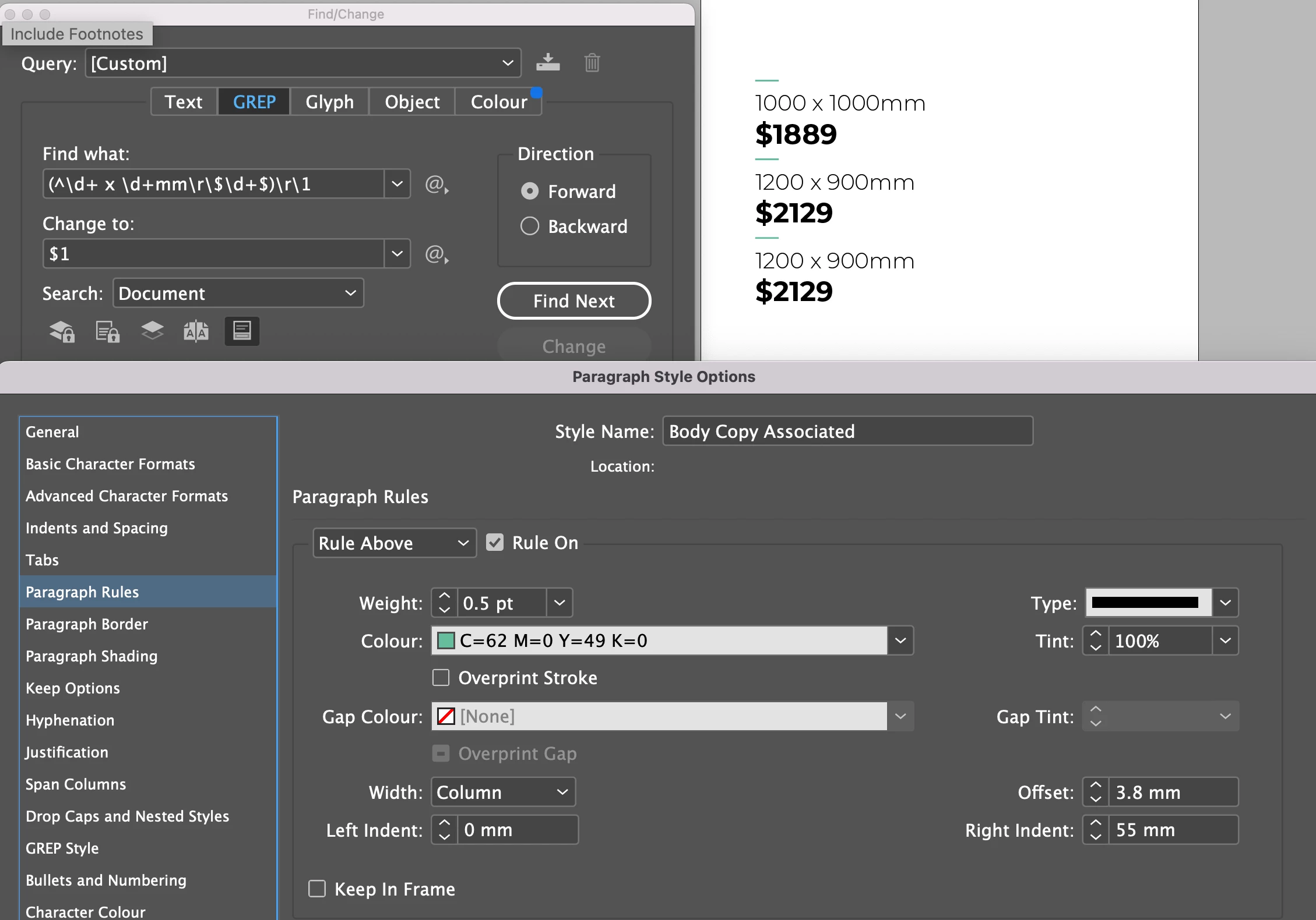

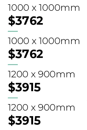

Hi there. I hope one of you intelligent peeps can help me with GREP issue. Been hunting around and nothing really helps. I have duplicate sizes and pricing within the same text box and am hoping to remove the duplicate. It is separated with a return after each line. Is this even possible? Or is there a script? So looked like this below, also repeats with lots of different sizing and prices (see screenshot attached).
1200 x 900mm
$4424
1200 x 900mm
$4424
Thanking you in advance
Anton

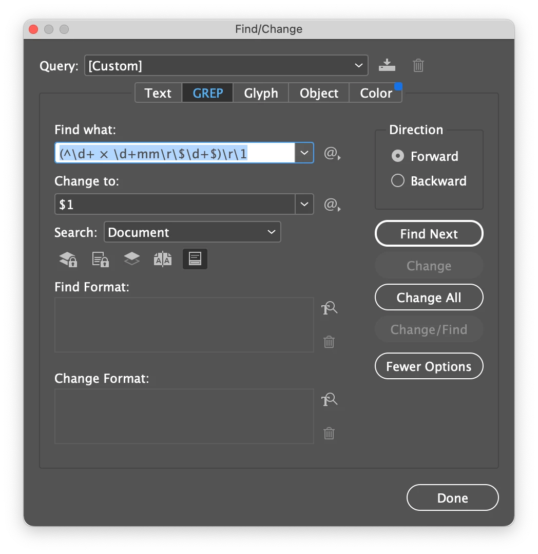

m1b
Feb 15, 2023 4:37 AM UTC
Hi @antone78177033, this worked for me:
Things to note:
• I've assumed there is just a carriage return after each line break and the short rule in between is done with a paragraph rule, not another line. If another line, put it in the grep.
• I might not have used the same multiplication character that you did, so put that in the grep if necessary.
- Mark

Hi Mark, firstly thank you so much for your quick response and woah and that's some GREP. It does says 'Cannot find match'? not sure if I miss-keyed anything (I don't think so though 'x' is just a normal x right?), see screenshot attached. Sorry for my dumbness, is a carriage return a hard return? This information is automated into InDesign, so these could be soft returns. The Short Rule in between copy is done with a Paragraph Rule within paragraph styles. I have attached small example in InDesign attached.
Thank you again for your help, it is very much appreciated.

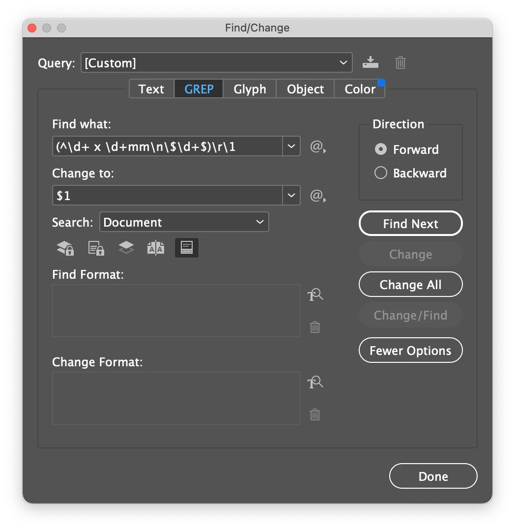

m1bCommunity ExpertCorrect answer
Feb 15, 2023 5:21 AM UTC
Okay, I see. You have a linefeed after the dimensions, not a return. Try this:
