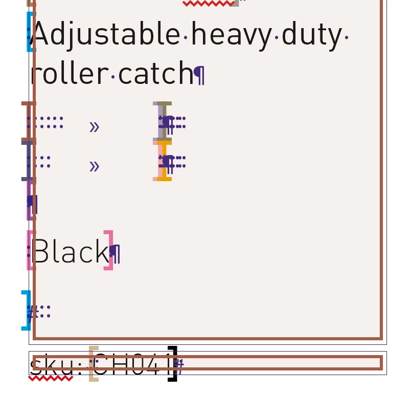

I need to remove the empty lines after datamerge for certain products. The checkbox to delete blank lines will not work in this case. I have tried to get the grep correct but to no avail, please can someone help. In my eg i need the "Black" to move up.

Hi Manan, the problem with that is it assumes the paragraph style from the text above the blank lines. also the \s+$ grep doesnt match the eg you mentioned:
as can be seen here after running the \s+$ grep. Even if there is abc tab tab paragraph.

January 22, 2020
Hi Manan, no that wont work it still would leave the paragraphs that have a tab for instance.
