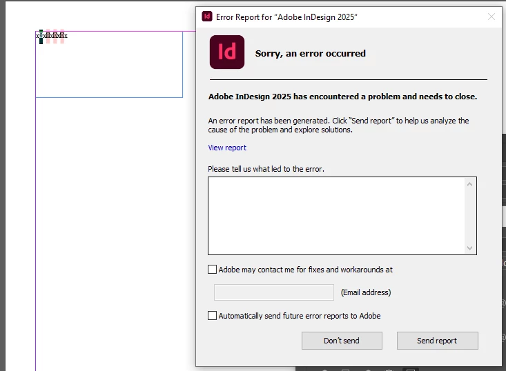

Not at first, it turns out. I recreated your frame, set up a Find/Change query in the GREP tab where I searched for \s and replaced with ~R, and it behaved in v20 exactly as it did in v19.
At least, that's what it did the first time. I then replaced the \s with an ordinary, whack-the-space-bar space and clicked "Change All" and found a different result:
So, I suspect that you've found a bug. The place to report such bugs is at indesign.uservoice.com, and such bug reports are best accompanied by a screen capture or recording.

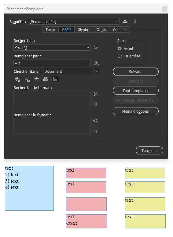

Can you show a screen shot of your Find/Change dialog box?
Jef.ModAuthor
Dec 3, 2024 11:18 PM UTC
So here's my Find/Change dialog box, underneath you have the green frame as my base to work, the red frames are the result in the latest version, and in green the result in the previous versions with the exact same inputs.
