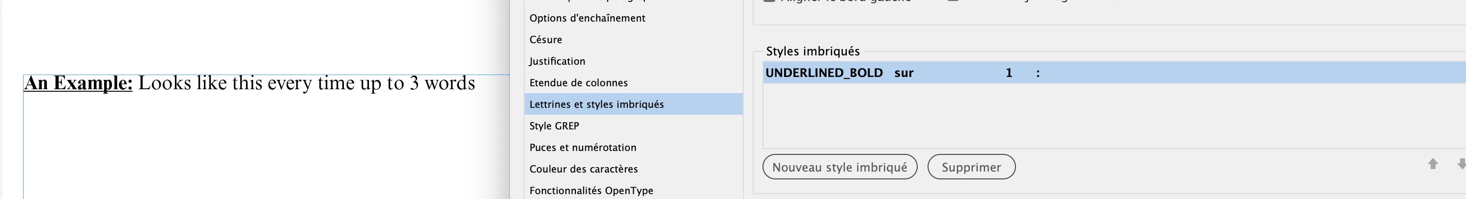

Why don't you use a simple nested style?
C.Lor
C.LorAuthor
January 20, 2023
Thanks for the suggestion but that applies it to everything except the words in the sentence that immediately follow the colon. I don't believe a nested style will work the same way a GREP style can, since a GREP can be much more targeted to a specific instance.
