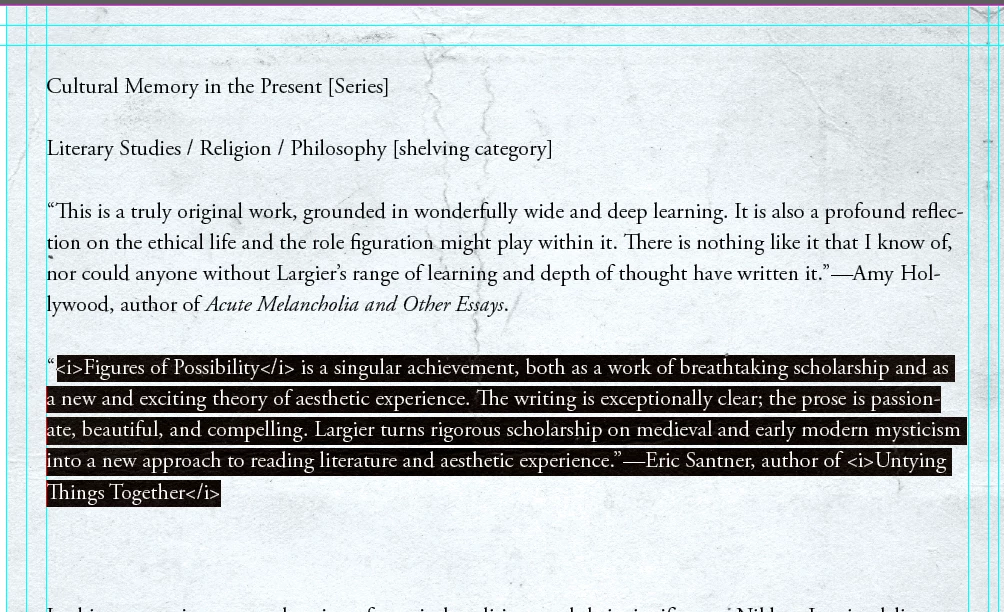

This works for the first find, Peter. But then, for some reason, the entire paragraph following is selected. As it happens that ¶ begins (after a quotation mark) with a coded phrase, and another shows up at the very end. See attached. Any ideas on why this would happen?

brian_p_dtsCommunity ExpertCorrect answer
December 3, 2021
Put a ? after the +. GREP is greedy by default. The ? limits that greediness.
