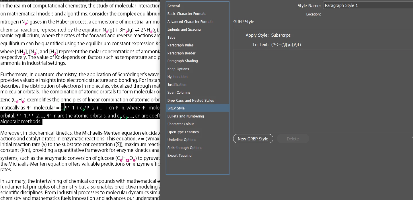

Just to add to other suggestions (I tried them and didn't quite work forme for some reason)
(?<=(\l|\u))\d+
But Caveat is that it will find other things that you might not want found.
Like C1 and C2 in the example

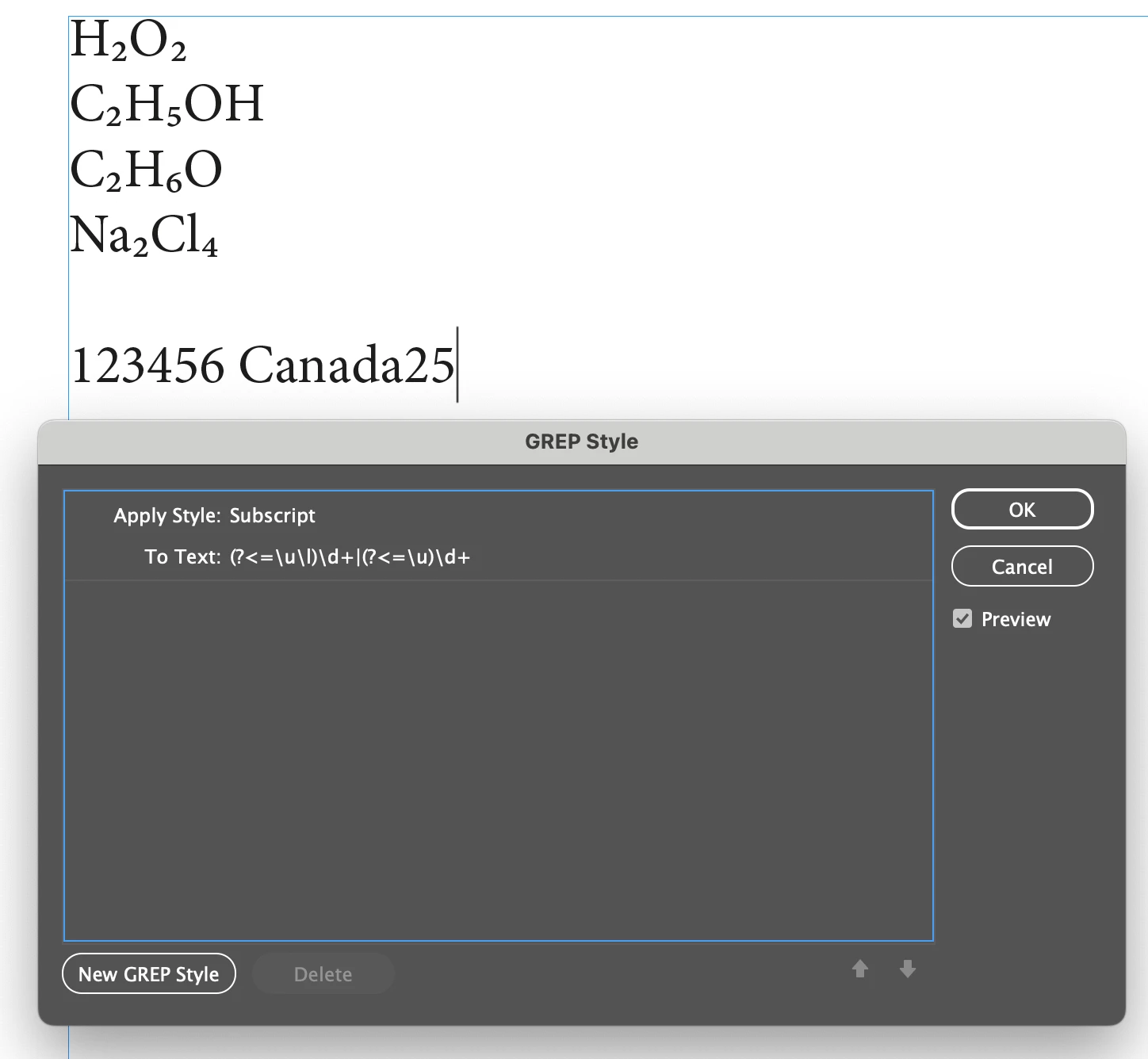

Scott Falkner
April 30, 2024
Use a GREP Style and this expression:
(?<=\u\l)\d+|(?<=\u)\d+
For the nerds: I couldn’t get the OR to work within one PLB.
Robert at ID-Tasker
April 30, 2024
@Scott Falkner
How about:
(?<=\u\l?)\d+
But I'm on my phone so can't check - "?" means "zero or one" so should work?
You are right - looks like "?" can't be used inside Positive LookBehind either.
