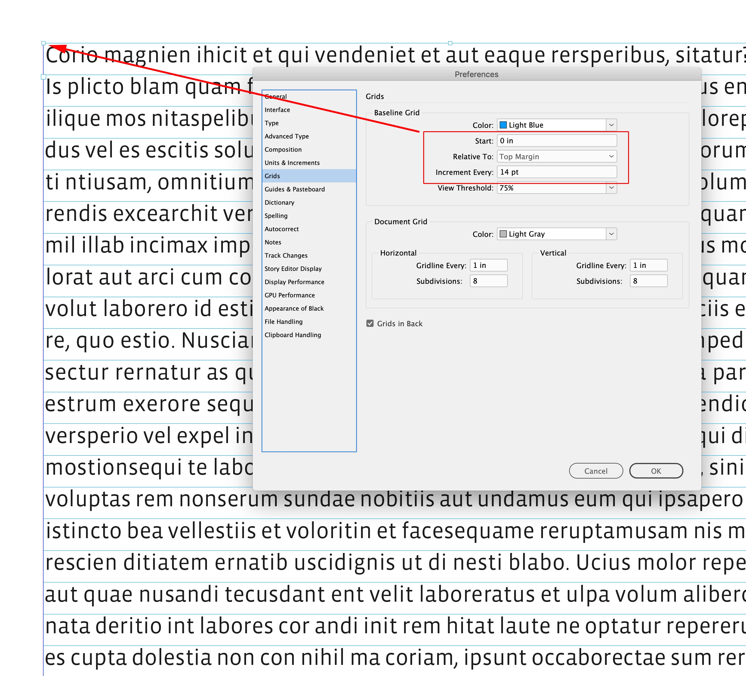

I’d like a grid or guides option with horizontal lines for:
  1. x-height of body text
  2. ascender height of body text
  3. base of body text
    Finding after an extended period of self study reviewing dozens of Taschen publications (and this applies far more broadly), photos and other elements often align to the main text's x-height, not just to base or ascender. For example, photo captions or the first line of margin notes or captions beside the main text don't align to the base of the body text, but rather their x-height top aligns to the top of the adjacent body text x-height. How are such guides achieved in ID? Seems ideal to have very light but different color guides for 1, 2, & 3 respectively.
    Admittedly this is a very incomplete understanding of grids in ID, but I'm aware of the goal: conforming and aligning elements to the main text's x-height. Many thanks in advance.
Correct answer rob day

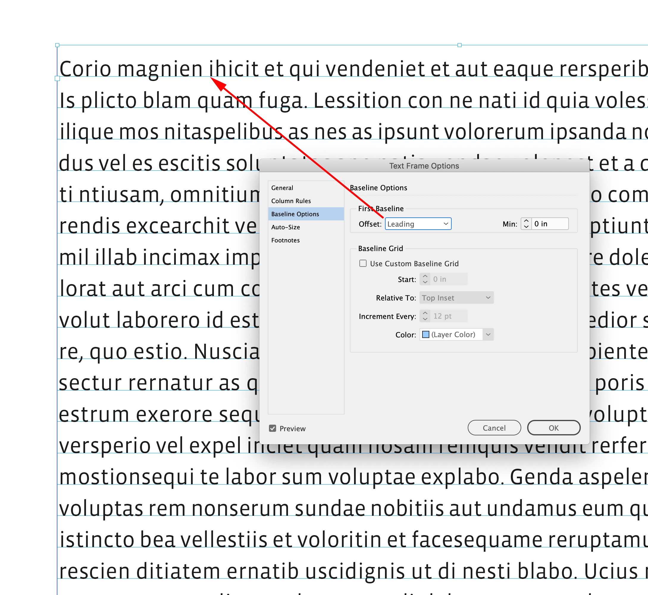

Hi @Typothalamus , some of what you are looking for might be handled by your Baseline Grid Preference setup and the Text Frame Options. Here I’ve setup my Baseline Grid relative to the margins and starting at 0

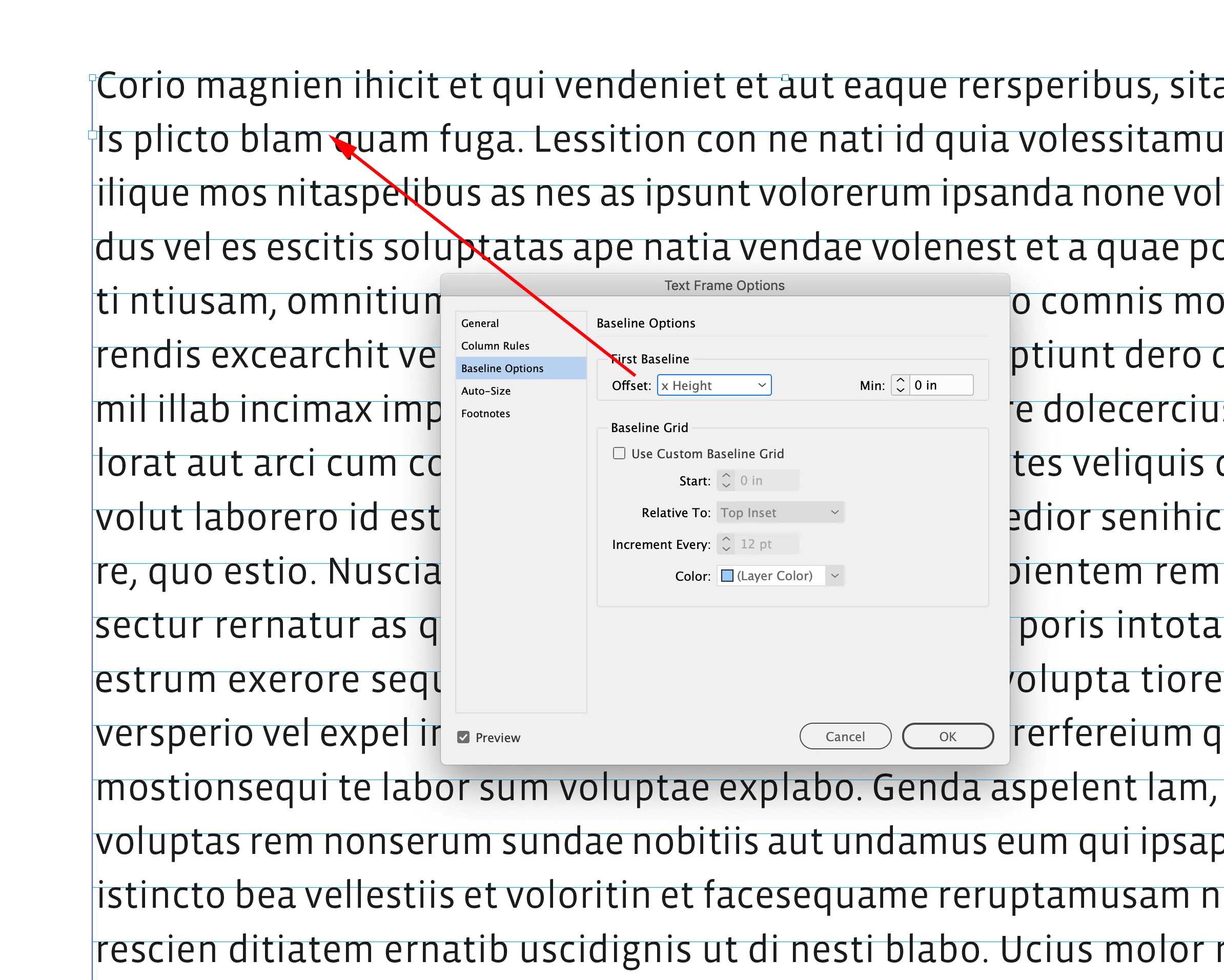

My text frame is snapped to the margin and its Text Frame Options First Baseline Offset is set to the default Ascent, so the 10/14 pt text’s ascent line lines up with the grid. I can change the First Baseline Offset to x-Height and the text’s x-height will align with the baseline grid
If I choose Leading, the baselines line up with the Baseline Grid.
The other option would be to set regular page guides to the font’s ascender and x-height lines, which can be scripted—keep in mind the ascender is variable and depends on how the font was designed. I’m guessing you would not want to try that manually
