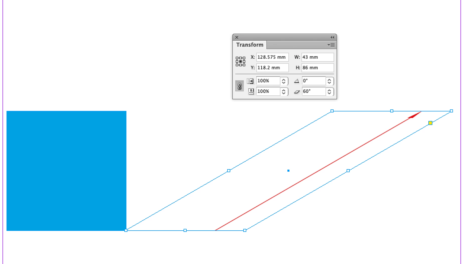

rob day
February 13, 2024
Hi @Stephanie27059601f7zd , Could you clarify how you are getting the rectangle’s  height? The Transform and Info panels are returning the correct Height for me—the Height is always 43mm with any rotation applied:

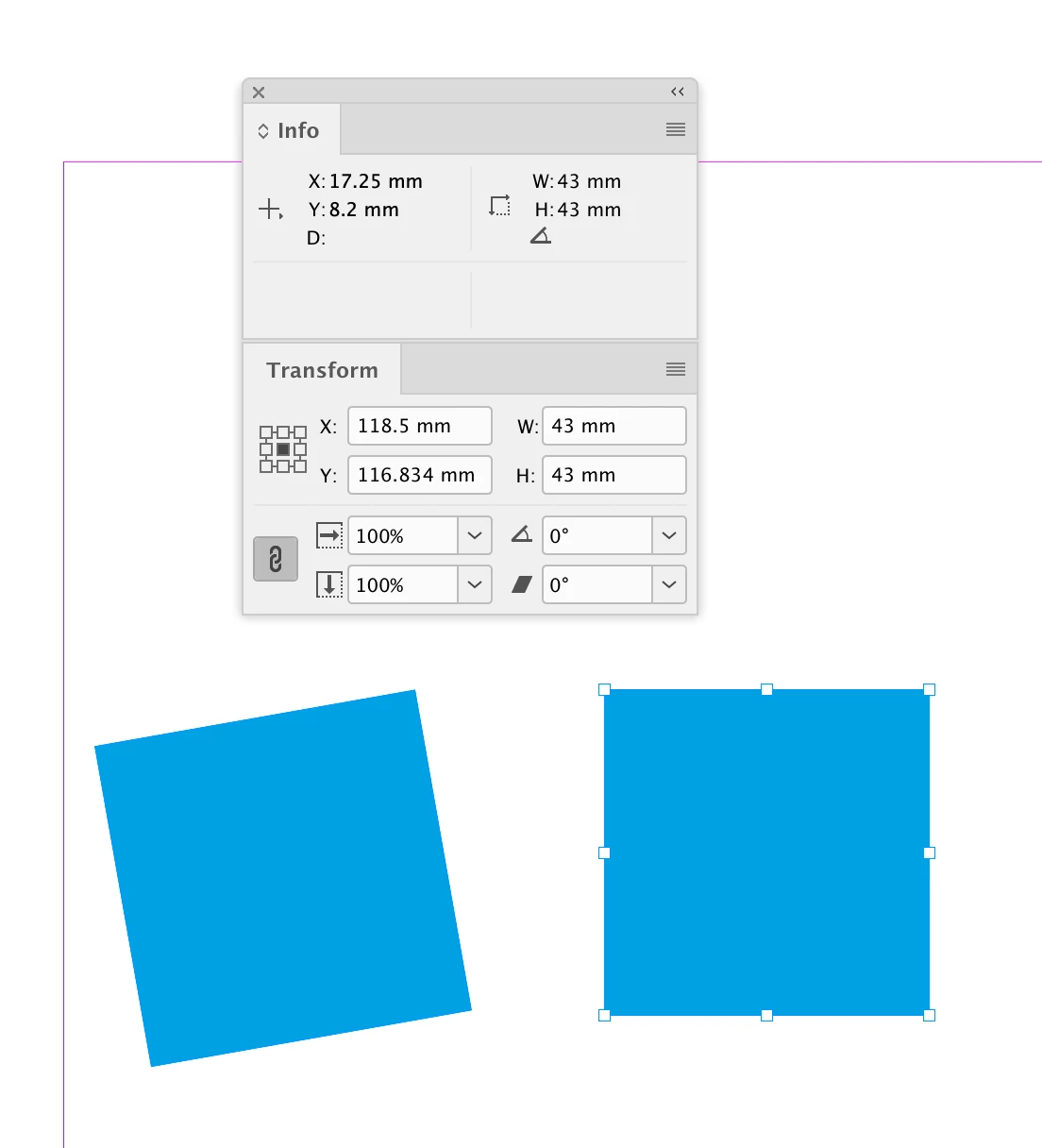

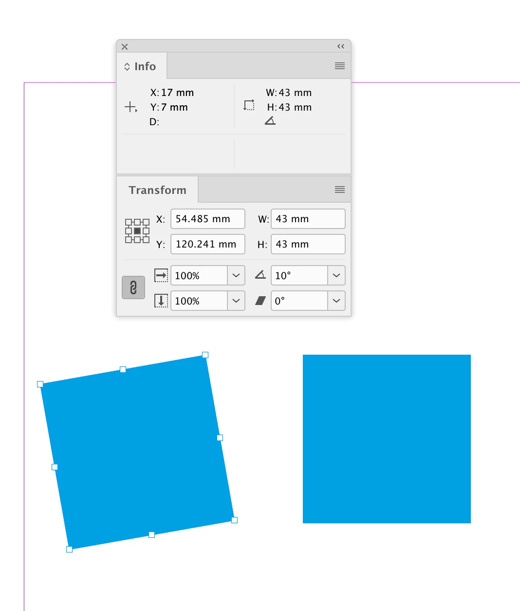

February 13, 2024
yes, I will try to explain.
I created two rectangles (see below 35 x 35 mm),
[cid:0069864a-daa0-4096-bd9f-0478ea746bd1]
then I tended one of it 10°.
It doesn`t changed height, but the info changed.
[cid:23d2e30a-675e-47ef-9a49-39d9e97b4077]
Marking up both forms, it tells me the right height.
[cid:b61881ae-fce0-475c-8129-f8cc7d2837d9]
My colleague tested it on his windows pc an got the same results.

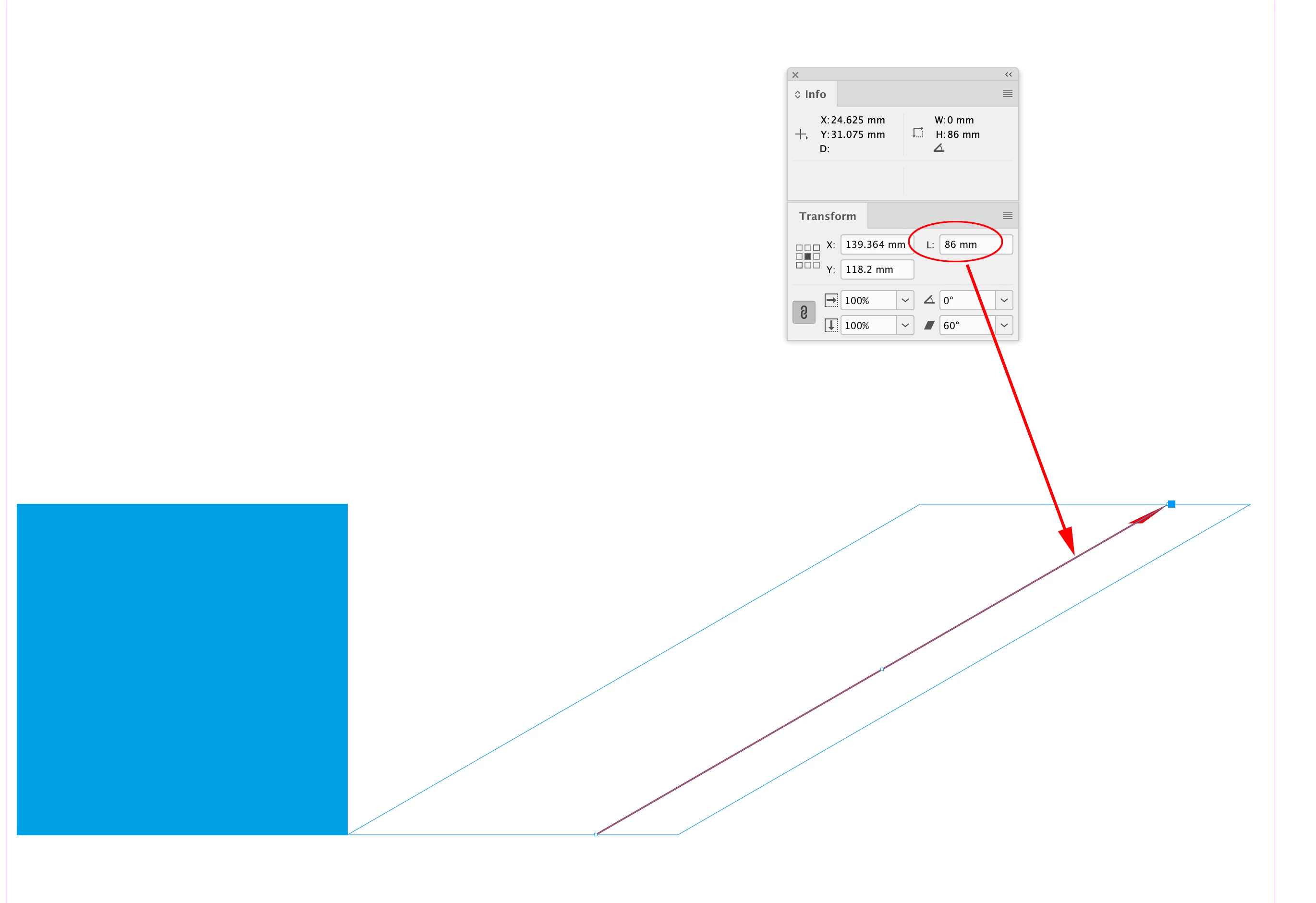

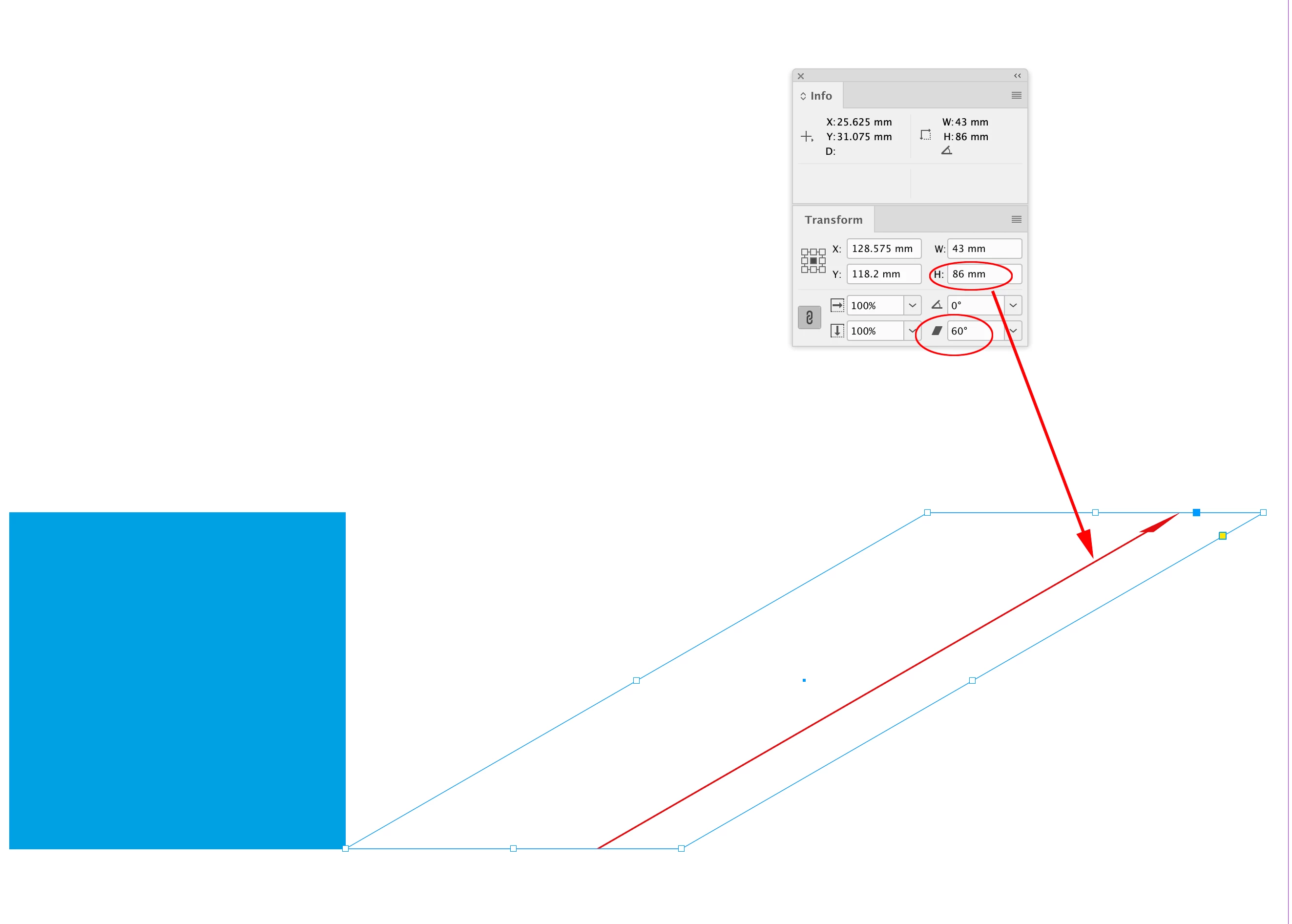

rob day
February 13, 2024
I think it is happening because on a Shear the Height equals the length of the parallelogram’s side. It‘s easier to see on a more exaggerated Shear:
