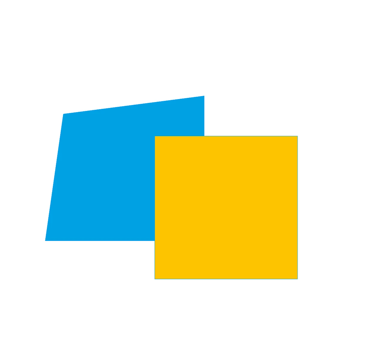

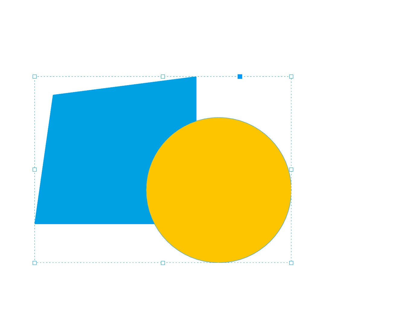

Hi Eugene, I don’t  think you need to resort to the menu invoke() method— there is the the selection’s ungroup() method. The question might be which item in the group do you want to convert to a rectangle?
//the first item in a selection–a selected group would have 1 item
var s = app.activeDocument.selection[0];
//check if your selection is a group
if (s.constructor.name == "Group") {
    //converts the first page  item in the group to a rectangle
    s.pageItems[0].convertShape(ConvertShapeOptions.CONVERT_TO_RECTANGLE)
//ungroups the group
s.ungroup()
Before and after
