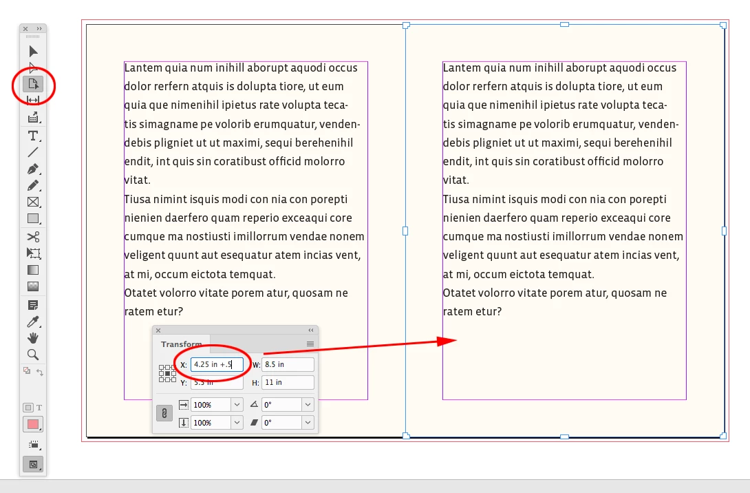

There is also the option of setting up the document with Facing Pages unchecked, and creating 2-page master spreads, which can be then split to get the inside bleed. With this method you give up the Align towards spine and Align away from spine text alignment feature, but that would be easy to get around with a few extra style sheets.
An exported PDF with marks:

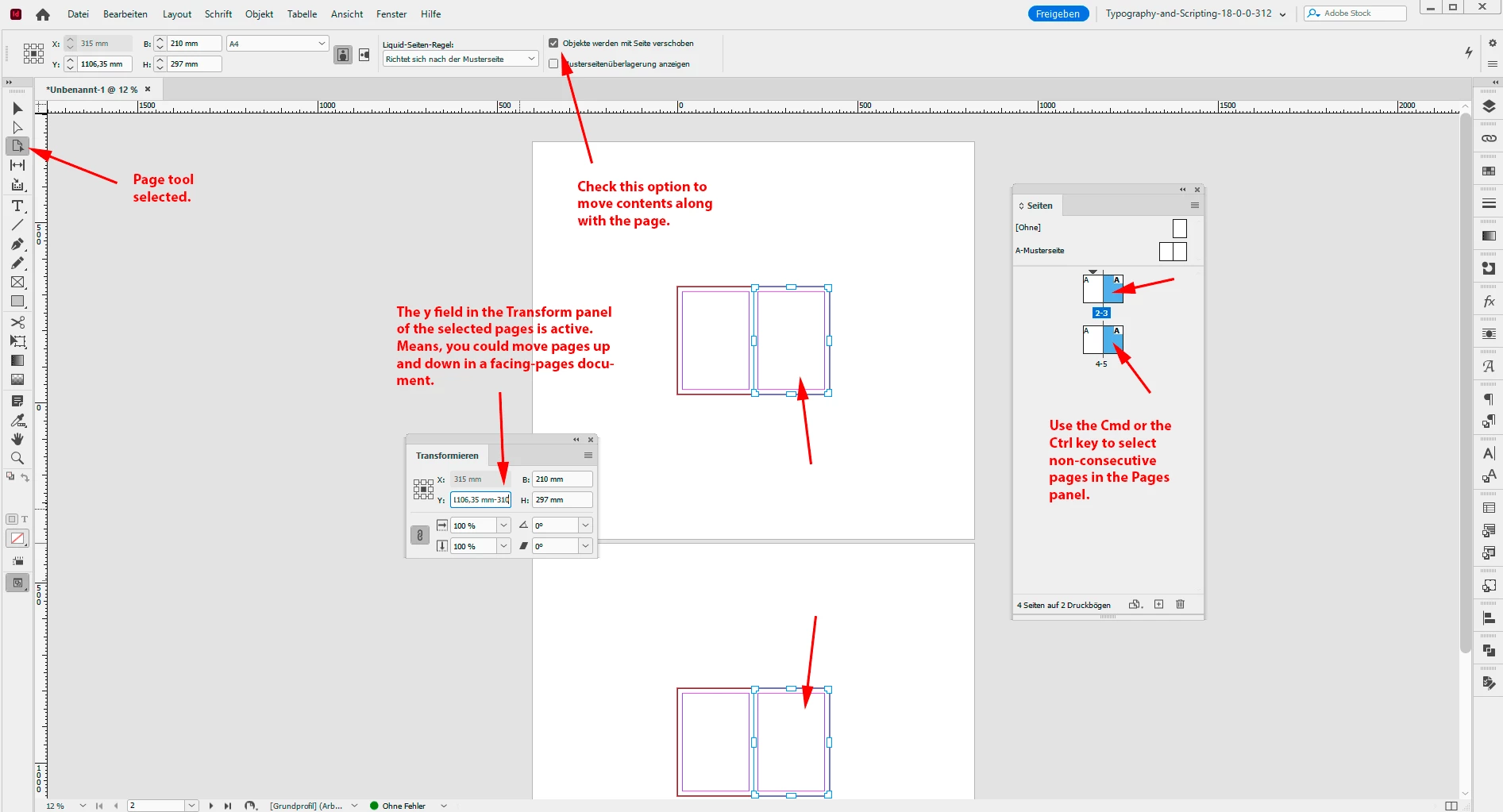

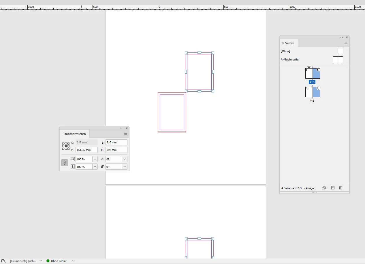

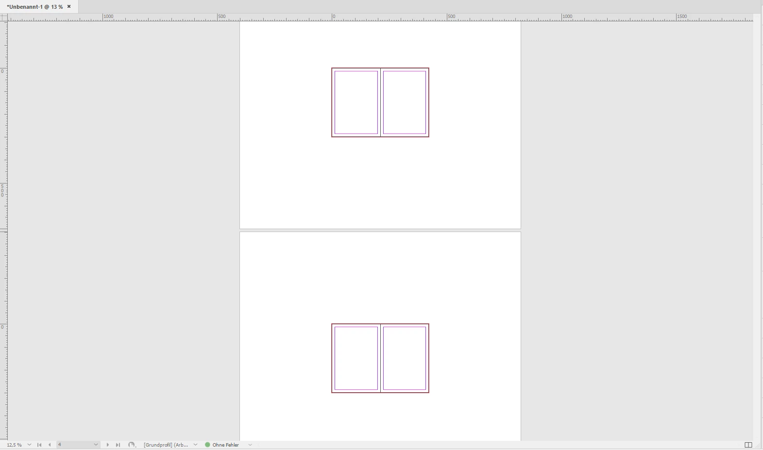

Hi together,

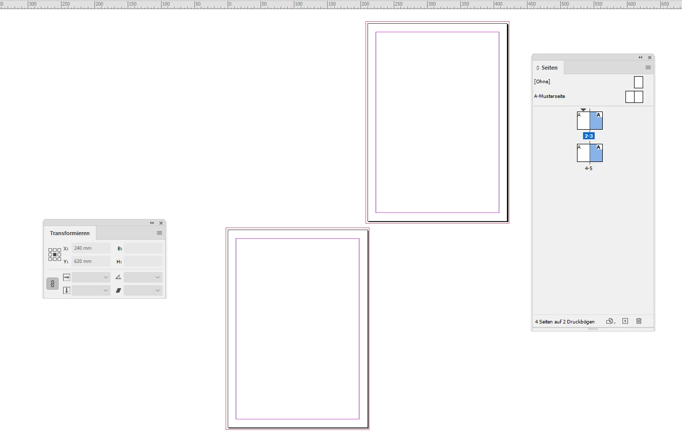

another method is to move the left or the right page with the Page tool so that both pages do not meet in the spine.
For this to do you need more space around the facing pages of a spread. Let's say 400 mm below and on top of a A4 document. Moving the pages can be done in one go if you first select the Page tool, then select every odd page in the Pages panel. The next step would be to use the Transform panel to move the selected page down or up with about 5 mm more than the page height.
From my German inDesign 2023 on Windows 10:
Result:
Result in detail:

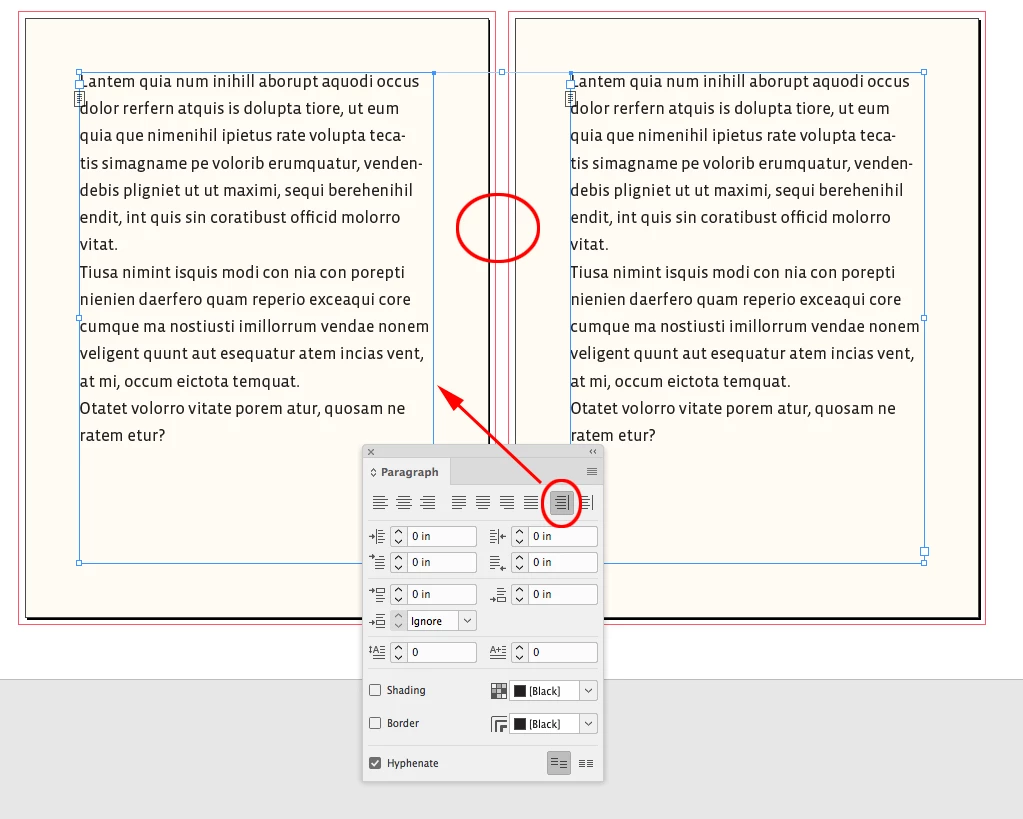

Why do you need an inside bleed? Is the binding method wire-o where the inside edge is actually trimmed and visible?
A document setup with Facing Pages turned off can still have 2 page master spreads. A non facing page document allows you to use the Pages tool to reposition the pages—select the right hand page of the spread and either drag it or use the Transform panel to move the X position.
If the document is not setup as Facing Pages the Paragraph justification setting Align Toward Spine does not work correctly
Setting the left text to Align Toward Spine does not work:

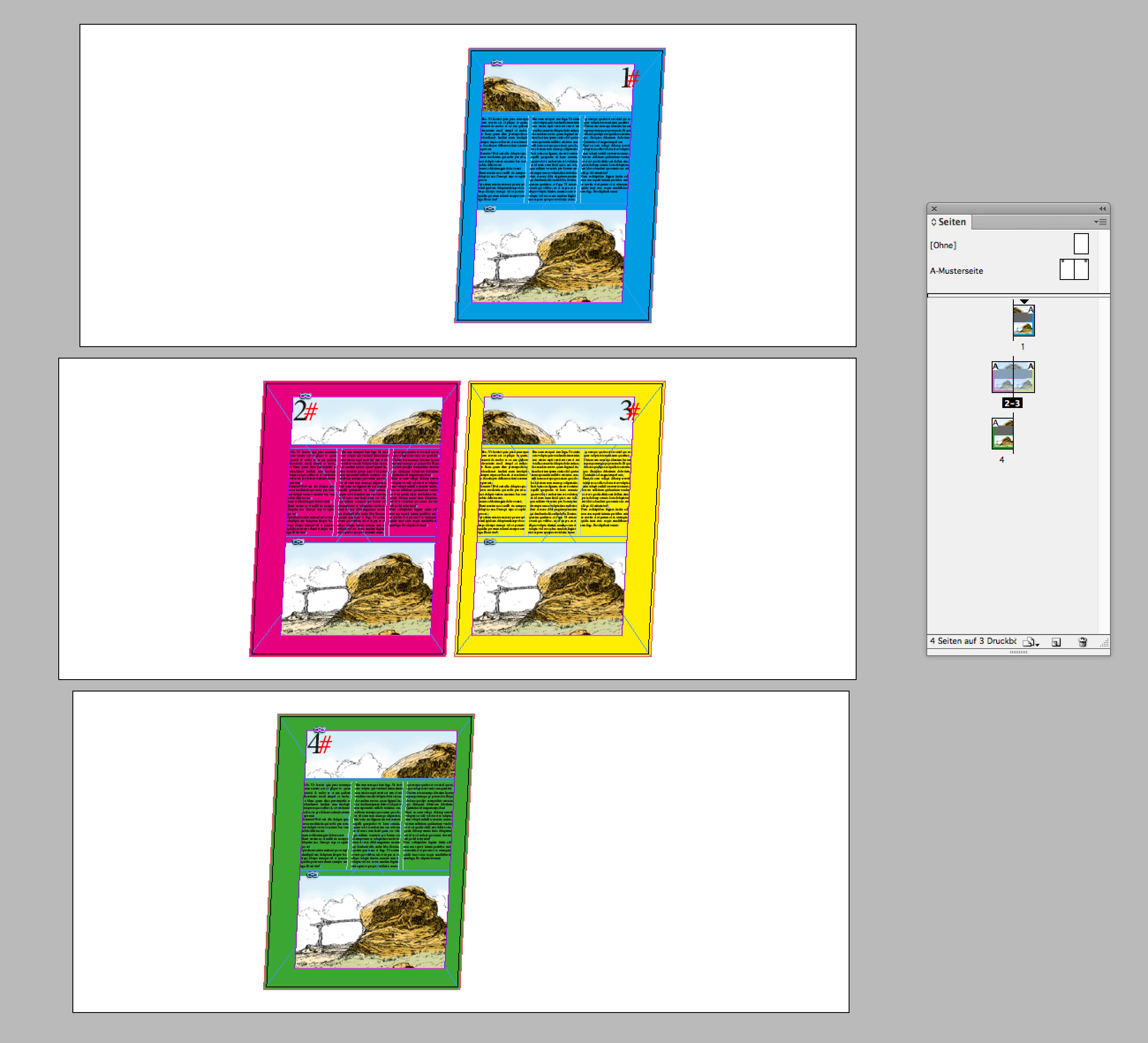

Hi Ken,
you missing nothing.
I know of two way to add unique bleed to the spine:
[1] Splitting a spread into two spreads where the even page is one spread and the odd page is in the other.
[2] A more experimental one where one is using the Page Tool and the Transform panel to shear the pages in the document. With this solution no new spreads will be added, but you have to live with a strange document.
Sample screenshot from my German InDesign below where I selected all pages with the Page Tool ( keyboard shortcut for Select All after switching to the Page Tool ) and set a small amount to the Shear field in the Transform panel.
After that I could expand individual elements horizontal to extend the page at the spine without overlap.
Note: Guides on the pages, not on the masters, cannot be sheared.
Uwe Laubender
