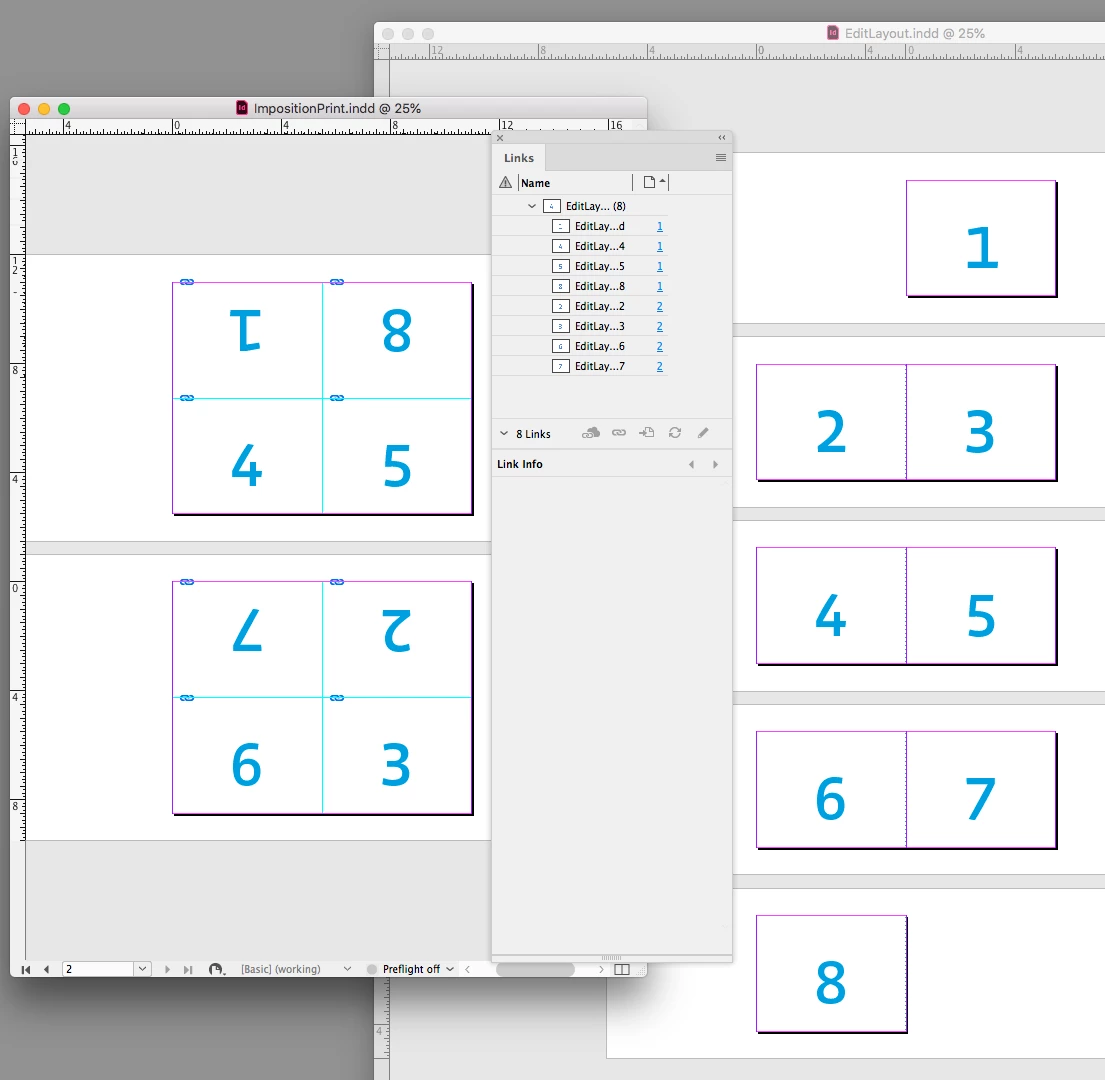

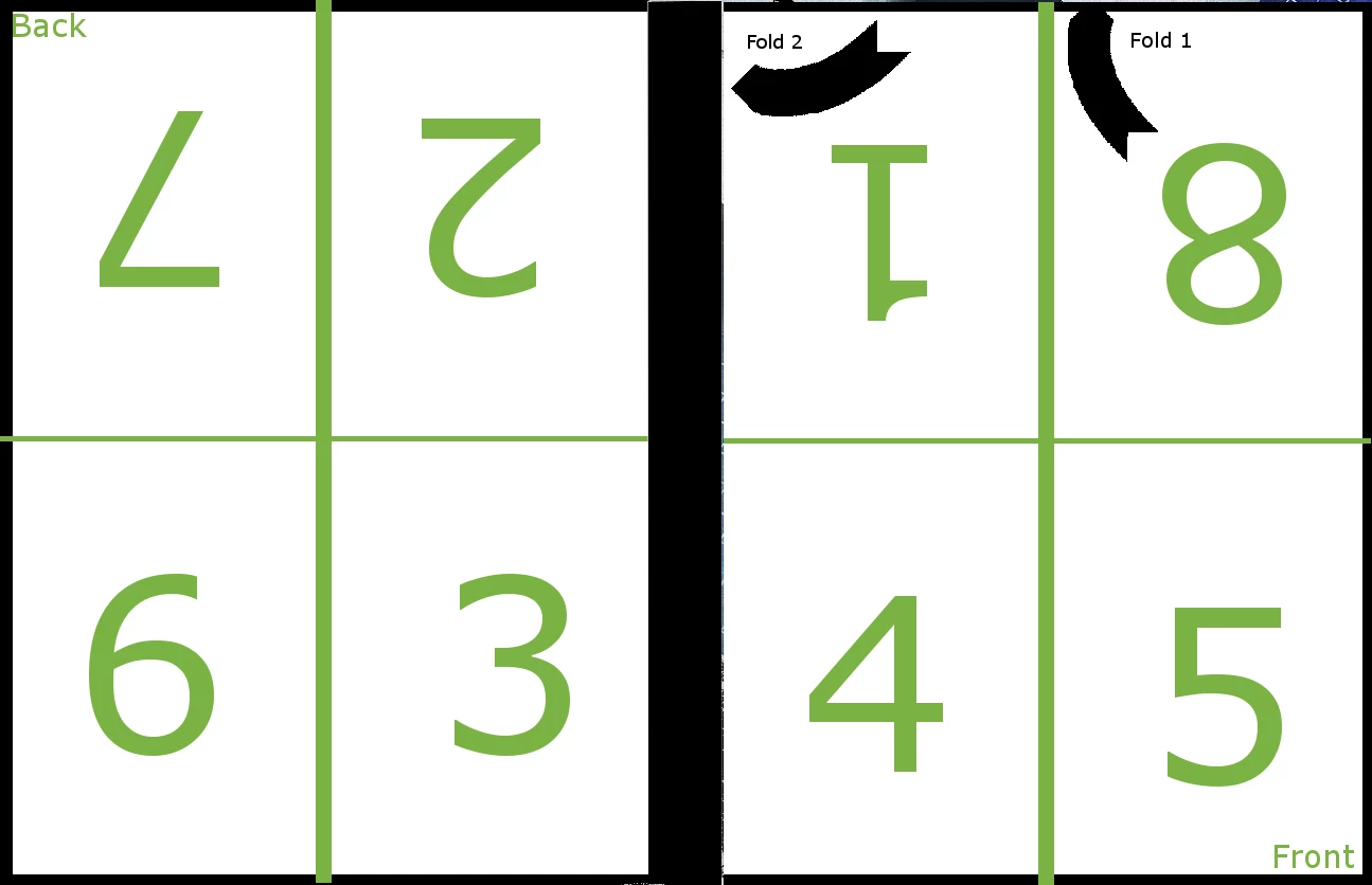

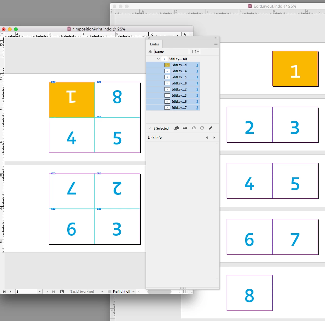

Print Booklet is limited to 2-up impositions. There are more complete imposition alternatives, but they usually are not free.
You could set up a 4-up impositon document, and place your reader document’s pages into the imposition document. This is a 4-up imposition guide for 8-pages. Place your 4.25" x 5.5" pages on the imposition document’s 8.5" x 11" page in this order front and back:
Thank you for your response, but this is not what I am trying to achieve. The final result is booklets that are 4.25 inches tall and 5.5 inches wide.
So I created my InDesign file with the final page size of 4.25 x 5.5 initially, and when I went to export it as a booklet it filled half the page and I couldn't "double up" or get multiple spreads on one sheet.
The quick solution was to make my pages twice as tall (8.5 x 5.5) and manually duplicate each spread to allow me to optimize each sheet, but I still wonder if there is a way to do it while keeping the original page size.
Edit: I think I understand what you mean, to move the pages onto the imposition document you suggested, but this seems a lot more complicated than just doubling the page size. Then I don't have to manually move each page onto your guide.
