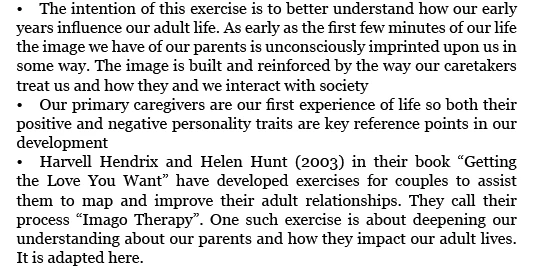

    I'm trying to do something similar, I think, but I can't seem to make the text in the subsequent lines to wrap under the text, as shown below:
    I want the text under the bullets that are part of the same paragraph to align to the text, not the bullet. I can't seem to work it out!
    Willi Adelberger
    Apr 27, 2017 8:14 AM UTC
    Did you try the advices above?
    Build up a paragraph style and use the settings in the Bullet & Numbered List section.
    Where do you find the problem?

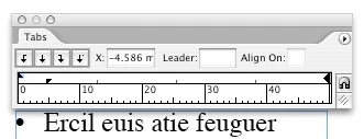

    Kath-H
    Jul 19, 2009 5:38 AM UTC
    Or open the tabs palette. Select your text box, then click the magnet on the extreme right of the text palette to stick it to the text box. Drag both triangles to the right, then drag the top one back to the left. Of course you have to put the bullet in manually.
