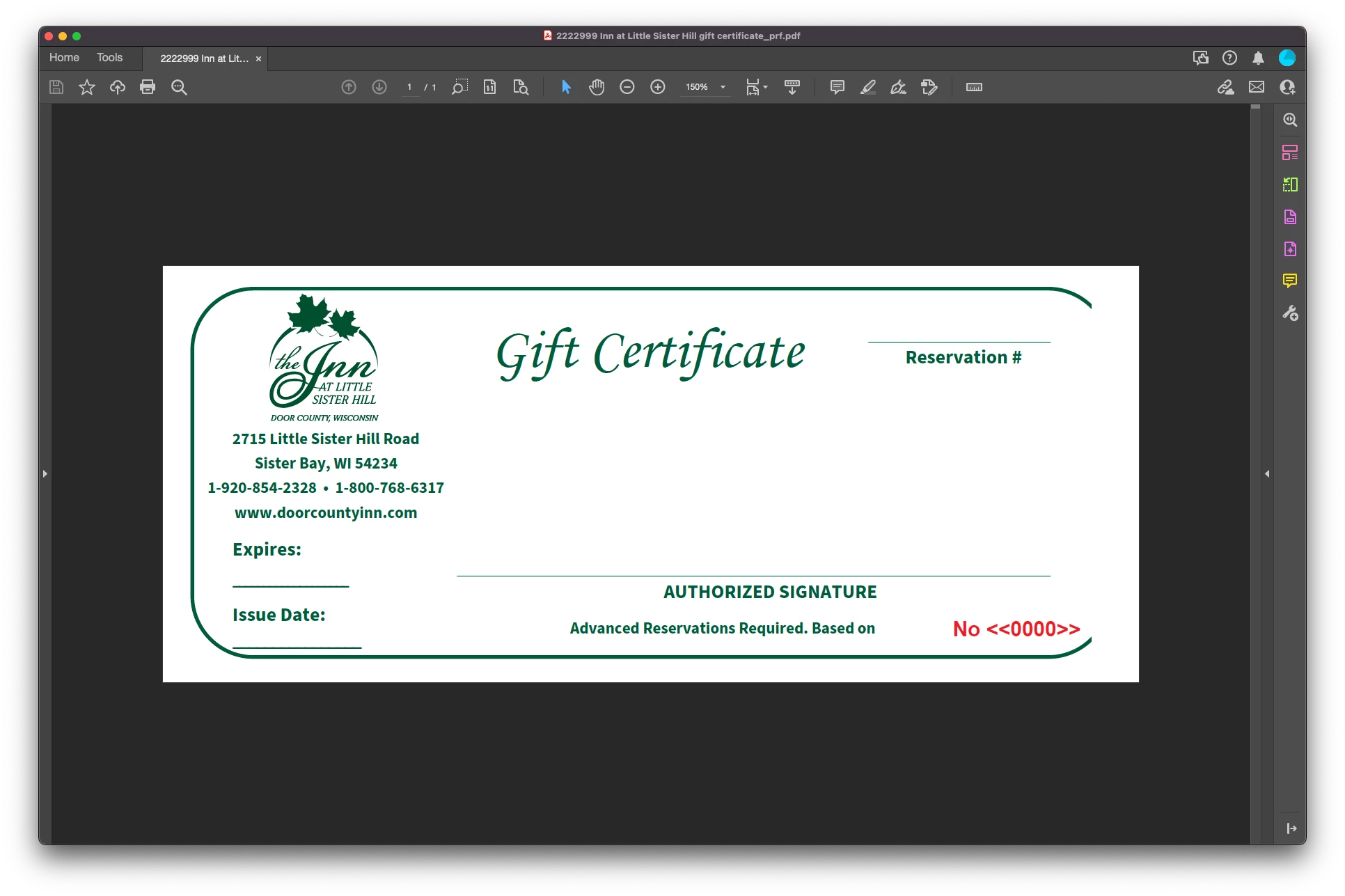

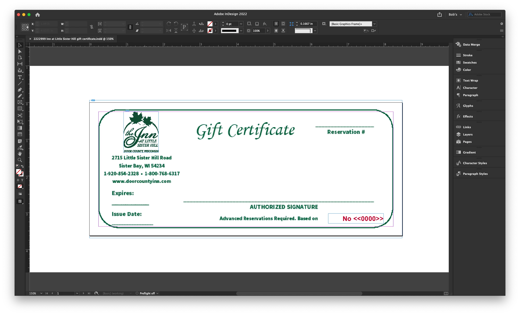

When I try to crop a pdf place in InDesign it won't let me do just the left or right side, it crops left, bottom and top or right, top & bottom. Like it might if I held the shift key, but I'm not.
Also, when grabbing and moving a picture it will move left or right, but not left and down. Won't let me slide it anything but in a straight line, nothing diagonally or just otherwise.

June 7, 2022
Check the frame fitting options...
June 7, 2022
It’s set to None.
June 7, 2022

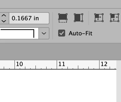

June 8, 2022
Could you have Auto-Fit selected on the Control panel for the PDF file? That would scale the PDF proportionally (like you were holding down Cmd+Shift or Ctrl+Shift).
