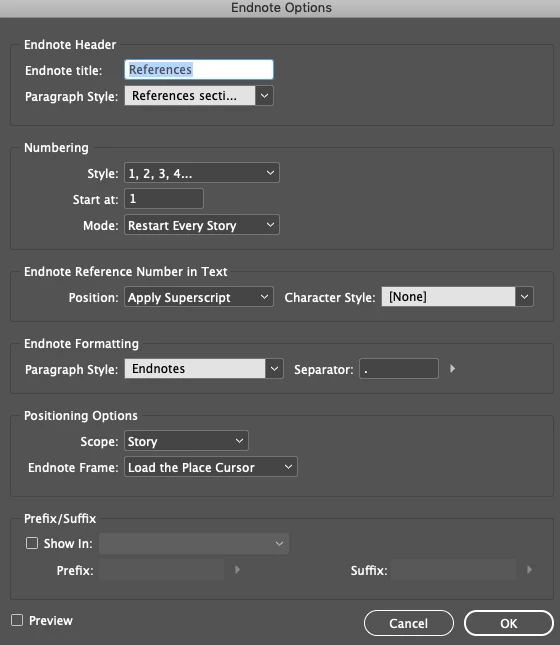

InDesign has only two options for end notes: end of document, or end of story.
To use the latter, each chapter has to be a separate story — a separate text flow in its own contained sequence of text frames. (This is, I find, a clumsy way to manage a document that's not a magazine.)
End notes don't know bupkis about "chapters" and headings and blank pages. Just "whole doc" or "stories." It looks as if you have things set up correctly, but you need to make sure your chapters are each individual stories within the structure.

March 18, 2023
I forgot to include a screenshot of my Document Endnote settings:
